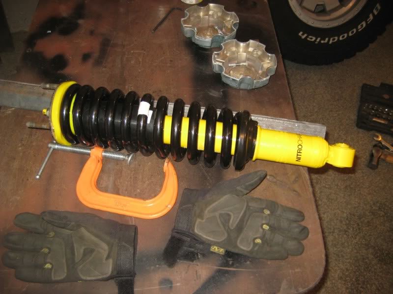

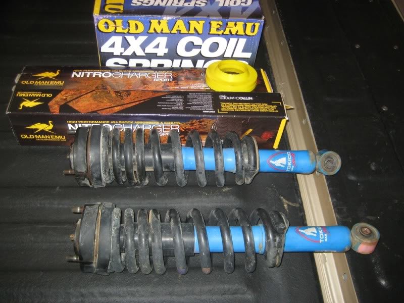

    As long as the top plate spacer is the type that goes between the top plate and the upper coil bucket on the frame it will be an easy install. Just pull the coilover, put the spacer in place and reinstall the coilover. Otherwise you'll need to take the coilover apart. You'll need some springs compressors if that's the case.
    Here's a photo of mine (which uses a different spacer) but you can kinda see that the spacer goes between the coil and the top plate so it required it to be installed with the coilover taken apart.
    Here is a photo of the stock coilovers that I took off of my truck when I installed the OME suspension. You can see that it is using two spacers. one is under the top plate like my OME ones, but there is also a second one that just sits on top of the top plate. If the one you get from Toytec is like this then it won't require you to take the coilover apart.
    You should consider new UCAs if you are not able to get proper alignment, particularly enough caster. From my experience, you shouldn't need new UCAs with the 881s. I have 882s which are a taller coil and I haven't needed new UCAs, so I would think you should be ok.
