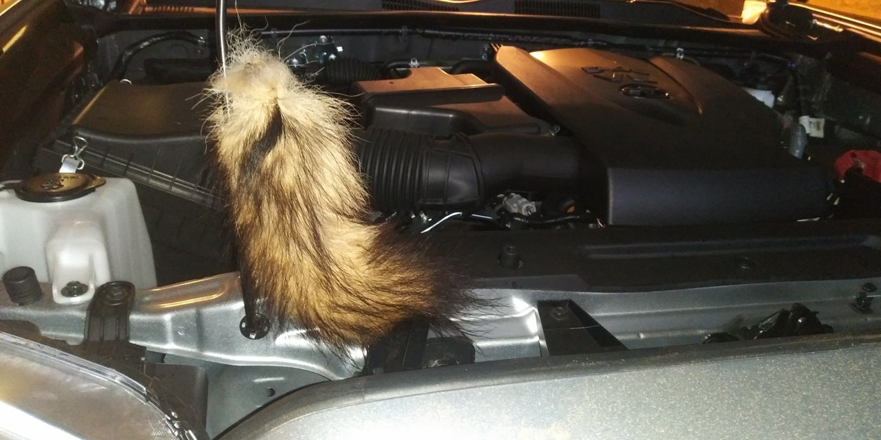

    Mouse deterrent device 6 inches of Coyote tail tied to hood support rod NO turds in engine bay I keep tacoma in barn next to feed room 20221213_072156.jpg
