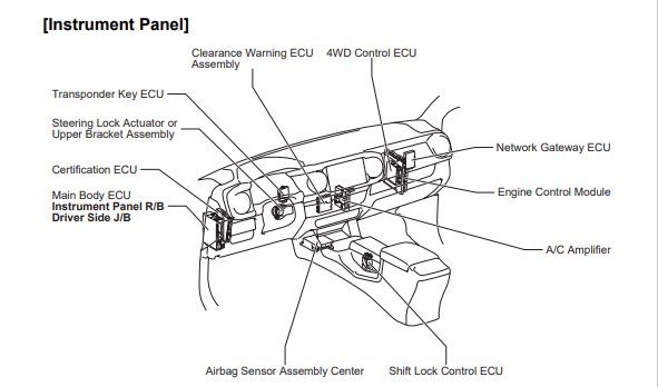

    to clarify, Tacoma has Body control unit and Engine Control Unit (ECU). Both are inside the cabin. upload_2023-2-8_9-44-59.jpg

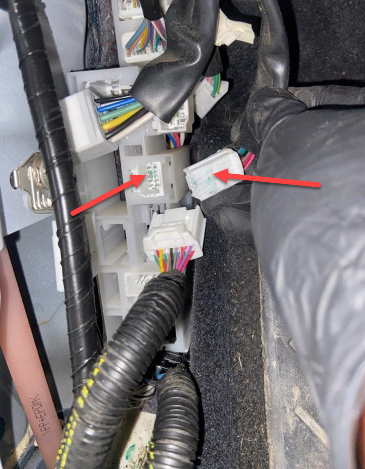

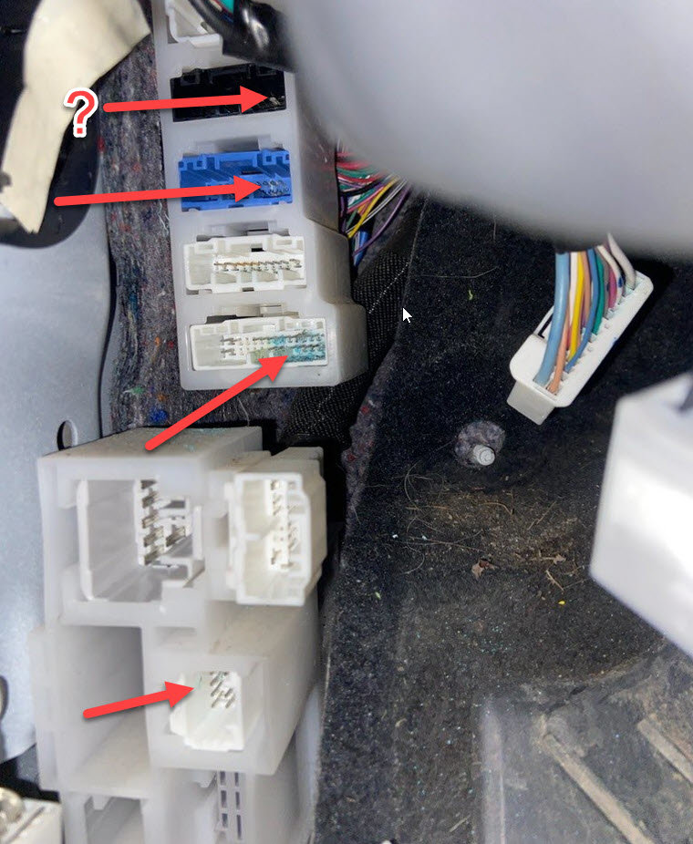

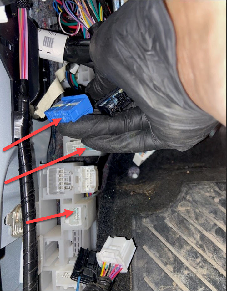

    Well, Dilbert won the challenge. Of course this advice was not omnipresent at the dealership, where I had already dropped it off by this time, so it took them another 3-1/2 weeks to get the same answer.
    It appears that because, in all their wisdom, Toyota designed the entirety of their major wiring systems to be draped in fabric that perfectly wicks moisture up onto them while simultaneously not sealing any of their connection interfaces, in scenarios where cars do not get to dry out daily (are parked outside and exist in a place where winter is a thing) they will invariably succumb to catastrophic corrosion.
    The dealership found a half dozen plugs that are corroded on the drivers side and require replacement of the entire vehicle wiring harness (at $2700 part) that requires in excess of $6000 in labor to replace. They recommended I reach out to Toyota's Corporate Assistance wing to see if they might consider helping rectify the situation, so I did that today. I was told, in a nutshell to pound sand. They did not care that the car was rendered inoperable in just 6 years and 70k miles, just that it was outside of the 3year 36k mile warranty, and it was on the owner to pay for their oversight. This goes without saying, this is my 9th Toyota, 4 of which I purchased brand new. My next steps are to try and cleanup the corrosion, since I can't afford or justify spending nearly 9 grand on a truck that its just going to happen again on because it will continue to live outside and get snow tracked into it, which will thaw and refreeze at some level every day in the winter and be damn sure not to buy another one, which is not what I wanted to be the case.

    I'm sorry to be the winner. I hay have had some experience in that area. I was denied warranty coverage, while under warranty, due to aftermarket wiring.

    Are you the original owner? This looks like a flood car or you have a leak somewhere (windshield?) getting water on those.
