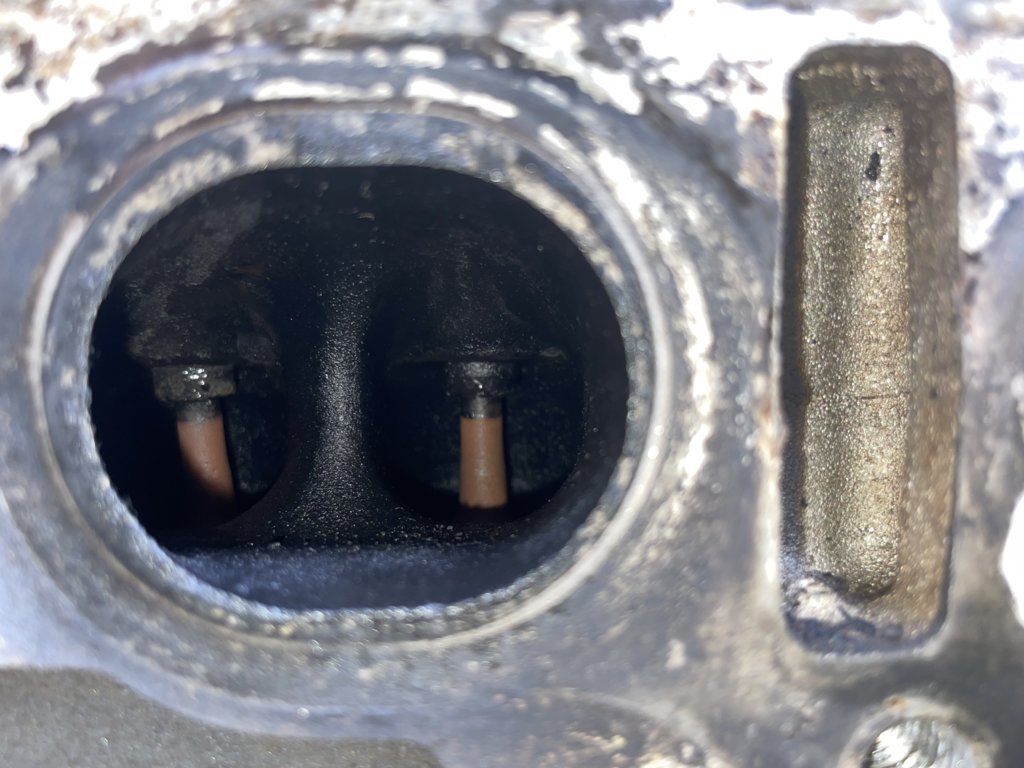

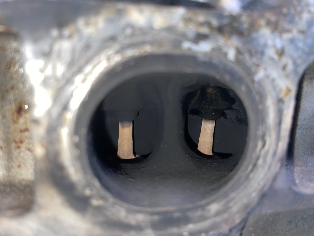

    This morning while addressing an exhaust leak I noticed that one of the paper towels I had stuffed into the #2 cylinder exhaust port was totally wet with coolant.
    upon further inspection 3 of the exhaust valves are leaking coolant. I’m not an expert by any means but this has to be either a cracked head or blown head gasket, right?

    This is the coolant burning off that dribbles into the cylinder when the truck sits. It "chokes" on the liquid coolant for a bit and then the engine smooths out. Very common sign of a headgasket leak unfortunately.
    That coupled with the (obvious) coolant coming out of the exhaust port and it looks like you have a blown headgasket or cracked head
    If/when you take it apart, check the cylinder head really good for cracks, especially between the valve seats. If you see a crack then you'll have to buy a rebuilt head. If you don't see any cracks at least send the head to a machine shop so they can clean them up and do a inspection and pressure test.

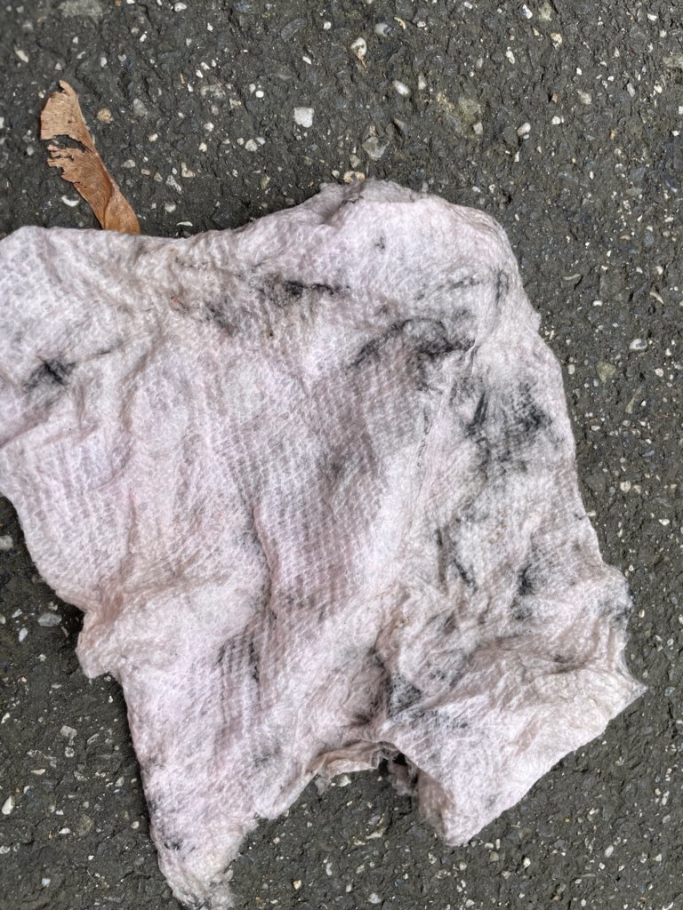

    are you 100% certain its coolant?
    Can you post a pic of the paper towel stain....
    If in fact it is coolant coming out the exhaust valve seat area when the exh valve is open & into the exhaust...
    You can verify that by boroscoping the cylinder & verifying that in fact theres coolant on top of the piston.
    Not sure how coolant would get pushed out of the combustion chamber with the engine off & paper towel sitting in the port....
    All im seeing from the pic you posted is possible oil leaking from valve stem guides....
    You need to dig further & Im not seeing the smoking gun from the pic you posted that equates to 100% coolant....
    Pressure test the cooling system overnight.
    Remove sparkplugs for the cylinders with the wet holes & send a horoscope down there & verify coolant. Thats the correct way vs rolling the dice on maybe this maybe that.

    This is the paper towel, although I think it’s probably dried out a bit now. When I squeezed it a few drops came out that appeared red but I’m actually color blind so I’m not entirely sure.
    I touched my tongue to the paper towel and it had that very distinct bitterness. I understand what you’re saying about the oil but if it were oil I feel like the paper towel would feel totally different and would have stuck to my hand, just felt like water to me

    looks pink....
    Think that confirms your diagnosis...
    Thats alot of coolant...

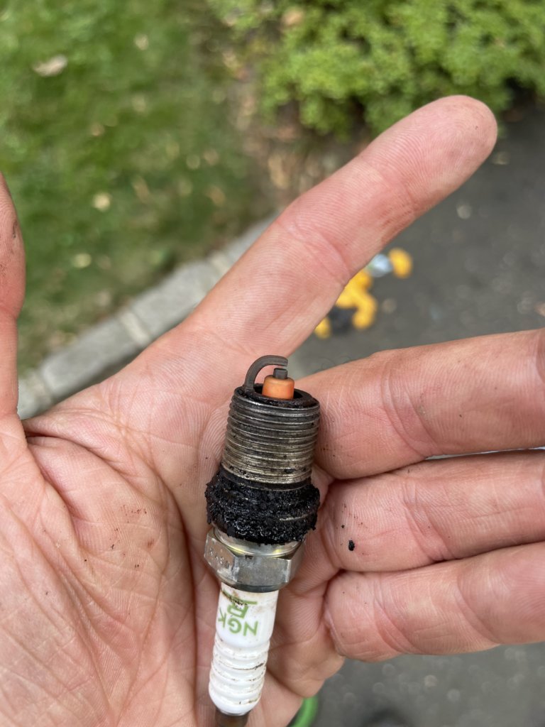

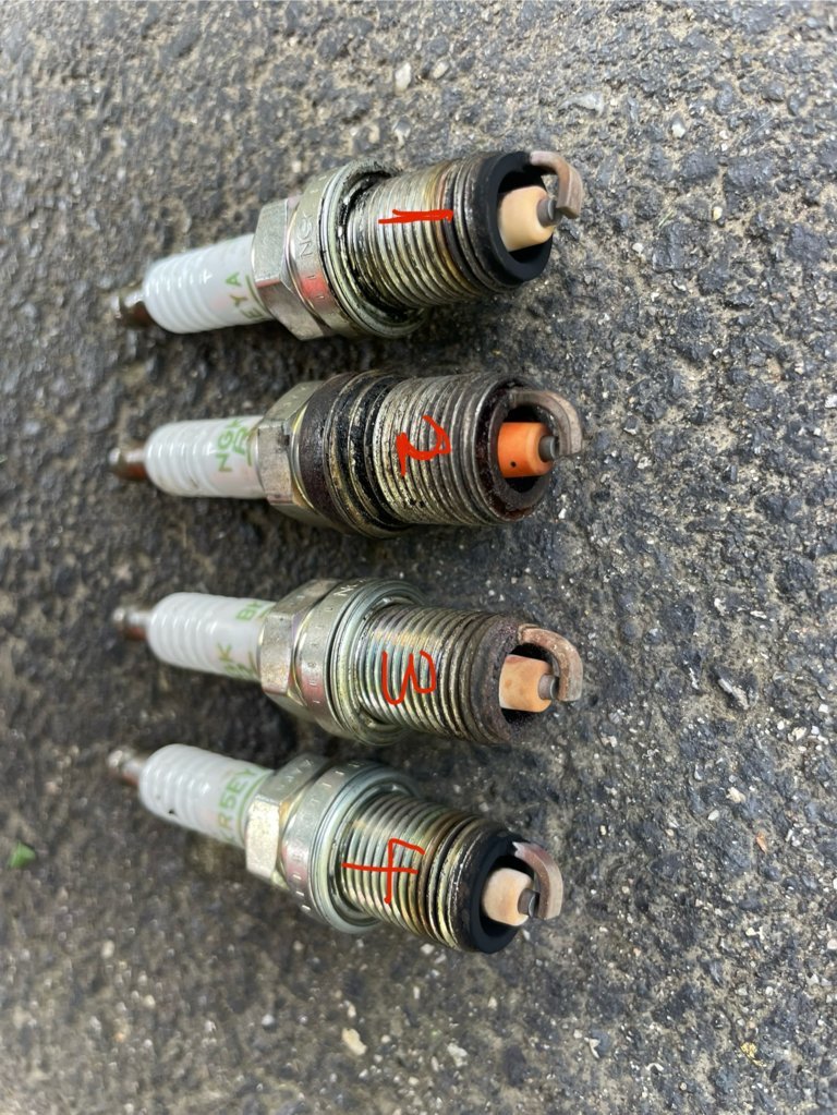

    Here’s what the spark plugs looked like in order from 1-4. I didn’t boroscope the cylinder but I shined a light in there and it seems like the #2 cylinder is the major offender.
    all of the pistons have that typical carbon build up including the one with a coolant leak. It just reflects back a little light from the moisture in there.
    I’m hoping the carbon buildup on 2 as opposed to the “steam cleaned” look some people experience means that this is a relatively new occurrence.
