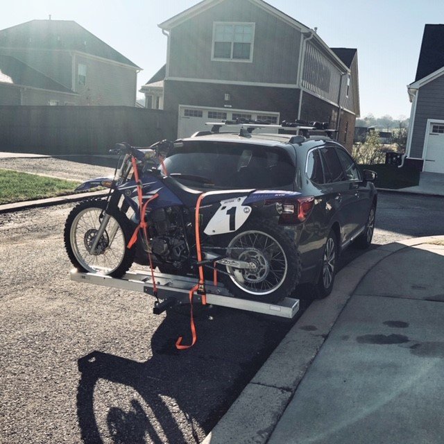

    I need to beef up rear suspension on the cheap for hitch hauling my dirtbike. I've got a 250 mile trip planned in two months from Nashville, TN to the far side of Georgia. I don't have the money for a new suspension setup on my stock '02 single cab 2.4L 2x4. It's going to be a haul, but I'm broke, don't want to rent a dirtbike there and all I have is my hitch hauler. Pics of my truck and bike/hauler included.
    If someone would point me in the direction of a thread of has info on what I could do? Looking for a solution under $150. THANKS!

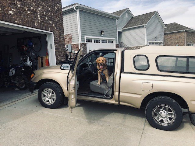

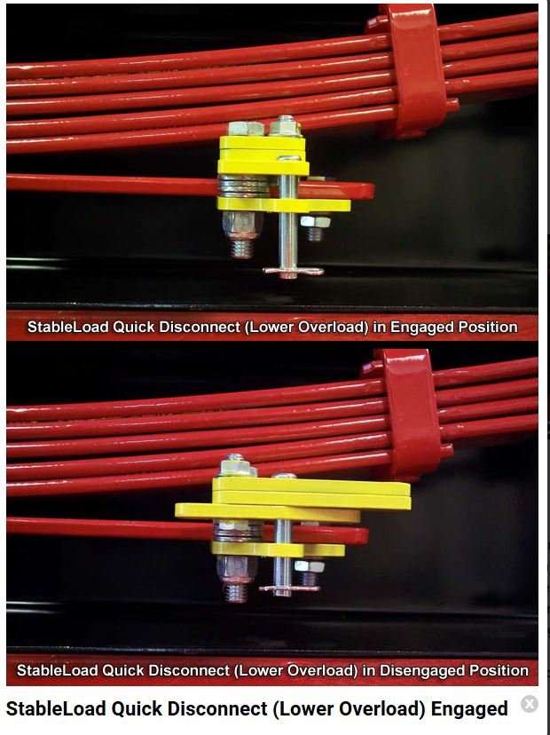

    They make these little clips you can bolt between your overload leaf and regular leaf pack to help preload your leaf pack for added weight. This may be nice for you because you can take 'em right off when your done.
    I forget what they're called but ill see if i can find a link

    Have you personally used these?? Seems like a quick, easy yet temporary solution for the trip.

    I have not. I just came across them one day and thought they were interesting. But apparently they have really good reviews.
    It takes up the space so the leaf pack is allowed to work to its maximum capability immediately. So that first inch of down travel instead of being, say, what 100 lbs or whatever, now is 175 lbs or whatever. It should dramatically improve handling and risk of sway etc.
    Looking at the prices they are rather expensive $300 or so :/ Not sure how mechanically inclined you are to make your own but the principal is rather simple!
    And I would't worry about shock mounts failing n all if anything will fail it will be the tires - would adjust psi accordingly

    I just looked on Amazon and they sell those StableLoads, but they want $349 for the ones in that image posted here.

    Dont use these. They will change the point of weight loading on the springs and either disform them or cause them to snap.

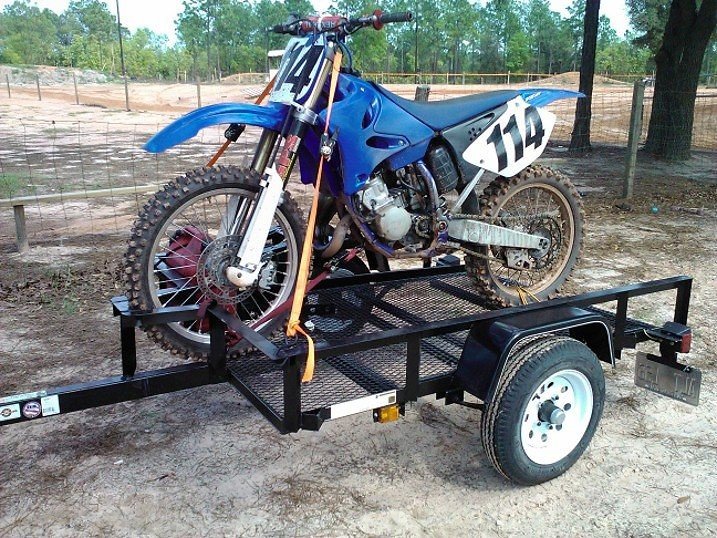

    Rent this

    I don't like the concept of helper spring as solution for preventing sagging. The geometry if the suspension with helper spring puts unusual load to original leafs that can make it break. If you put extra force between the frame and the axle that force must be supported by something. There is no free lunch (except from dumpster). Helper spring changes the geometry of the suspension making that extra force to load spring lengthwise. The spring is not designed for that.
    The concept of of StableLoad is also not ideal. What it does it puts the additional force from original "overload spring" to one point of the main spring pack. The overload spring shape is designed to apply equal force (spread across big surface) to the main spring. StableLoad changes it to apply the same force just to one point. That will increase the risk of breaking springs.
