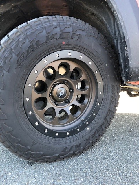

    Falken 265/70R17 AT3w rubbing on mine ;(
  14. Feb 14, 2018 at 1:43 PM
    REKER
    REKER [OP] Well-Known Member
    Jan 6, 2016
    #174160
    103
    Virginia Beach
    2016 Magnetic Gray Tacoma TRD Sport 4X4 - DCSB
    That looks pretty significant. Does it rub on both sides and is that the only area?
  15. Feb 14, 2018 at 1:47 PM
    Batman!
    Batman! Well-Known Member
    Jul 29, 2017
    #225327
    293
    Juan
    IG: moddedtacomas
    can hook you up on lug nuts $ 30 shipped
    driver side only.. in the process of buying a lift kit as we talk

    First I've seen with that size rub. Caster might be super low.
    Batman![QUOTED] and REKER[OP] like this.

    That's correct, your caster setting might be on the lower end of the spectrum. Get that maxed out and note that not all 265/70/17 are created equal. Some are just a tad taller/wider than others and vice versa.

    Update: took everyone’s advise and got a new alignment, guess what? No more rubbing! Yee!
