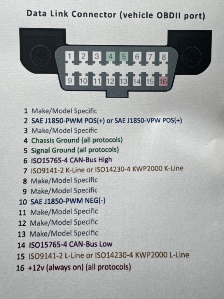

    Assuming the 03 in your profile:
    Pin 4 (White/Black) Chassis Ground
    Pin 5 (Brown) Signal Ground
    Pin 7 (White) SIL terminal (K-Line) (Communication/Data Line)
    Pin 13 (Yellow/Black) TC Terminal (Used for certain diagnostic/reset procedures)
    Pin 16 (Violet) Battery Power from OBD Fuse (7.5A)

    I meant to say that which protocol is used for the OBD2 scan diagnostics for the 1st Gen Tacomas ?
    1. KWP2000
    2. ISO9141-2
    3. CAN BUS
    4. ISO15765-4
    5. ISO14230-4

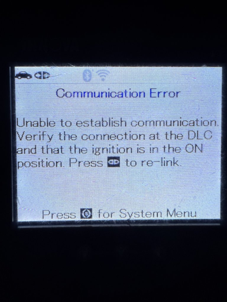

    I am trying to pinpoint which wire is NOT getting a signal when I put my scan tool onto the OBD2 port ?
    The previous owner had CUT the OBD2 connector off , I was able to trace and locate all wires ( Thanks to Dm93 ) and I soldered a new connector. But , I am getting a connection error , unable to communicate with vehicle.

    It's less Tacoma and more mod
    It's ISO9141 on early models but it changes on later ones

    This is a generic image and not from a Tacoma as a reference.
    Thanks again appreciate your information knowledge.

    It communicates on Pin 7 which according to the standard OBDII connector layout should be ISO9141 also known as K-Line.
    I belive it rests at 12v when it's not communicating but I'm not 100% on that.

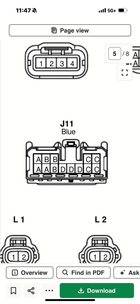

  12. Sep 11, 2025 at 9:23 AM
    gusto11071
    gusto11071 [OP] Well-Known Member
    Jun 17, 2020
    #331669
    739
    Juan E.
    Brewster, NY
    2003 Tacoma Ext Cab DLX 2.7L 4X4
    Rear FJ Cruiser Disc Brakes, Front Tundra Brakes, Heated 4Runner Mirrors, 2018 Tacoma OEM 18" Wheels
    I have to trace pin 7 White wire to J11 connector , I think that is where it’s not making contact

    I don't have 03 on my phone but here's for 02, I would think it would be in the same place.

  14. Sep 11, 2025 at 9:47 AM
    gusto11071
    Jun 17, 2020
    #331669
    739
    Juan E.
    Brewster, NY
    This helps a lot ! Thanks again

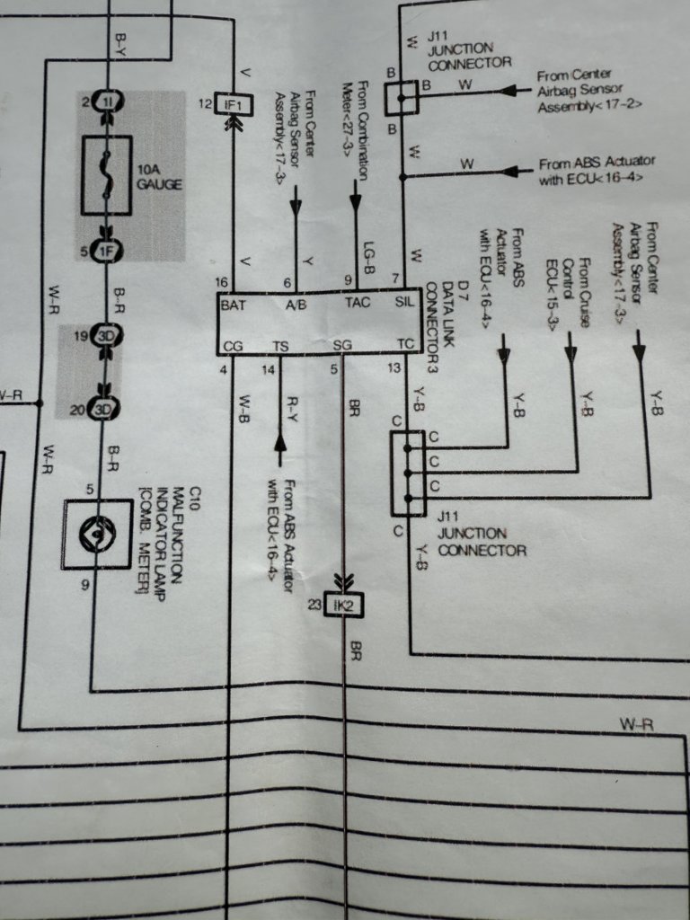

    Dm93 do you have the before and after page of this circuit in PDF ?

  17. Sep 12, 2025 at 8:40 AM
    #17
    gusto11071
    Jun 17, 2020
    #331669
    739
    Juan E.
    Brewster, NY
    The D7 connector page
