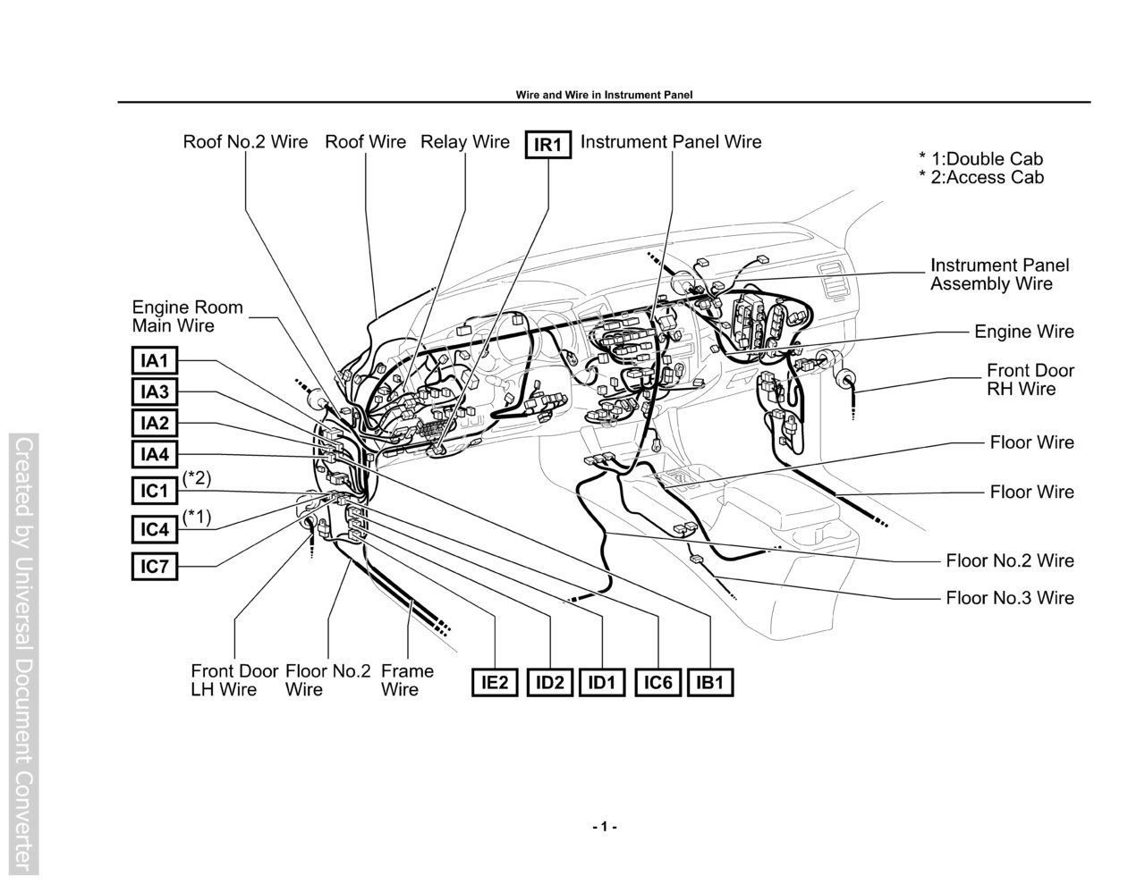

    You may want to check connector IB1 behind the drivers side kick panel, it has been known to develop a bad connection there.
    Tacogar61[QUOTED][OP] likes this.

    Just checked it. All the pins look good and no corrosion.
