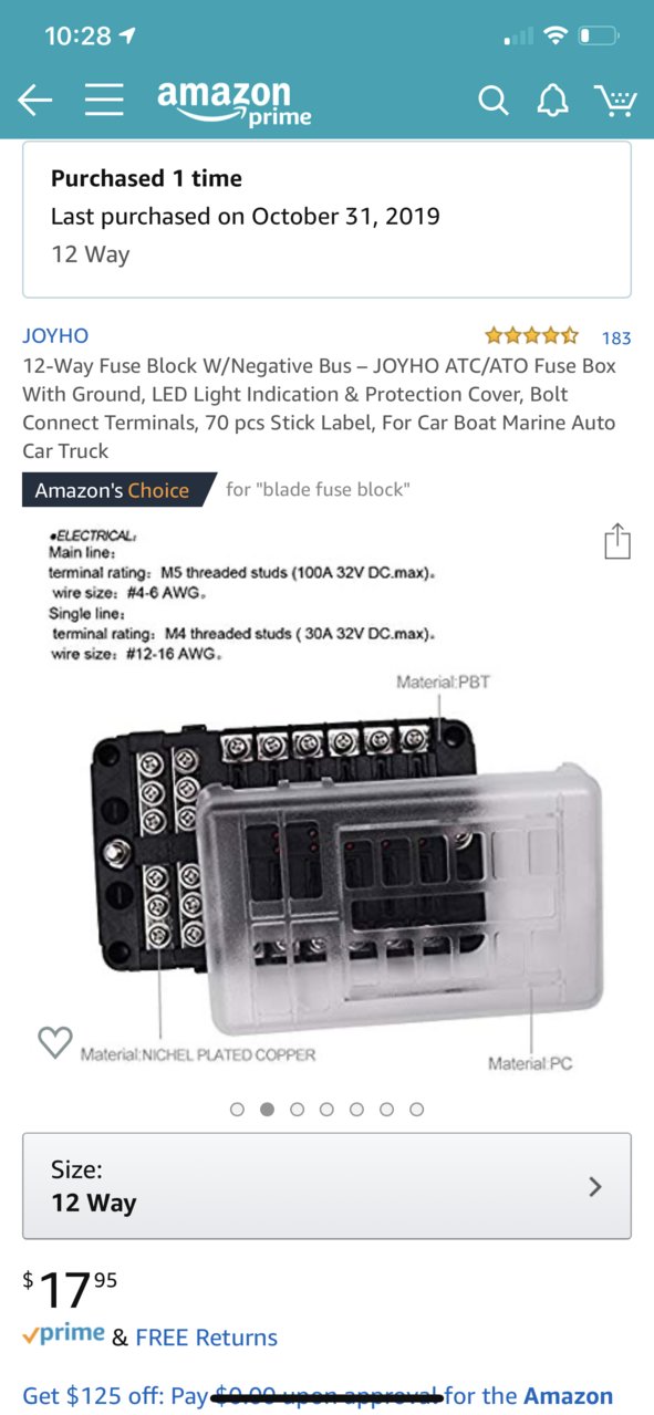

    This thing is coming tomorrow

    This is why is use a fuse block and relay for almost everything
