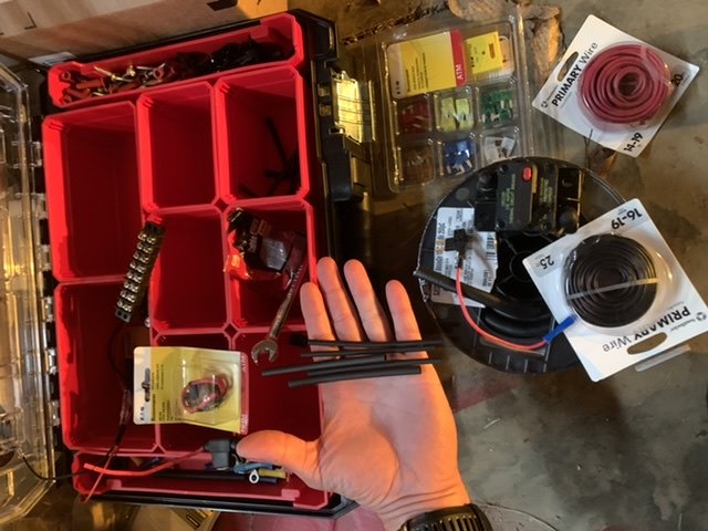

    I’m completely open to suggestions but I bought a roll of 6/3 gauge wire and two rolls of 14 gauge red and black wire yesterday at Lowe’s. Should I get lower gauge wire in your opinion?

    This is really getting out of hand. The lights are 2 amps each. The KC harness has a 30 amp capable switch and 16 gauge wire with a 15 amp fuse. (can be lowered to 5amp one) We have yet to see where he nicked the wire to cause the smoke. My guesstimate is before the fuse coming from the battery, hence why the fuse "failed".

    Has it? He bought the lights and harness off a TW member so who know’s what exactly he got. Switch smoked so we don’t know what electrical knowledge this person possesses. It’s a 2017 Truck so we are trying to keep him from setting his truck aflame. Everyone’s skill is different when it comes to electrical. Maybe we just want to ensure he understands the potential (pun intended) to do things right or wrong.
    Regardless of amp draw, everything I run goes through a relay or solenoids.

    My concern is that we haven't narrowed down the root cause. It worked on the ground out of the truck, then toasted a switch once installed. Thats something worth figuring out, preventing, and learning from.

    Worth it. Get everything in order, lay it all out, have the tools, terminals, heat shrink, etc in place and then tackle the job. A $17 fuse block and $8 relays doesn’t really instill confidence in my opinion.

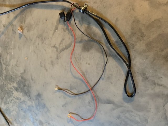

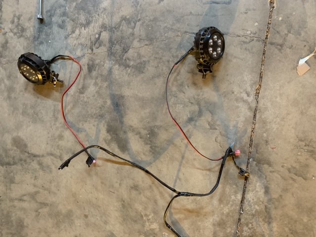

    00FF7E28-9F83-4CF4-AAFC-4F581C35DB7B.jpg B2D6ECCA-1091-4F06-B028-C74282845097.jpg So this is the setup I had with everything connected but sisconnected yesterday as soon as smoke started out of freaked out reaction for those wondering E7D9FB3E-0081-4635-88DA-A5D473020E6A.jpg

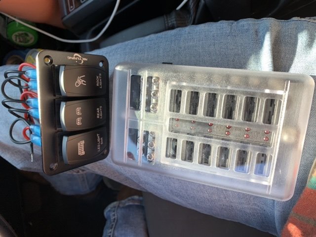

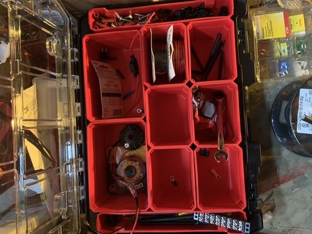

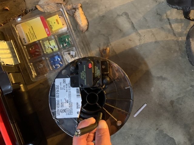

    59499C85-90AE-4684-A17D-C97B7E57BD75.jpg 4929154D-08E5-40F2-84AD-FC68986C84FB.jpg E6828963-1443-4BE5-ACE5-A8B18AE69EAB.jpg Here are all the supplies I’ve bought for my cyclones my ditch lights and led light bar that I intend on installing ASAP

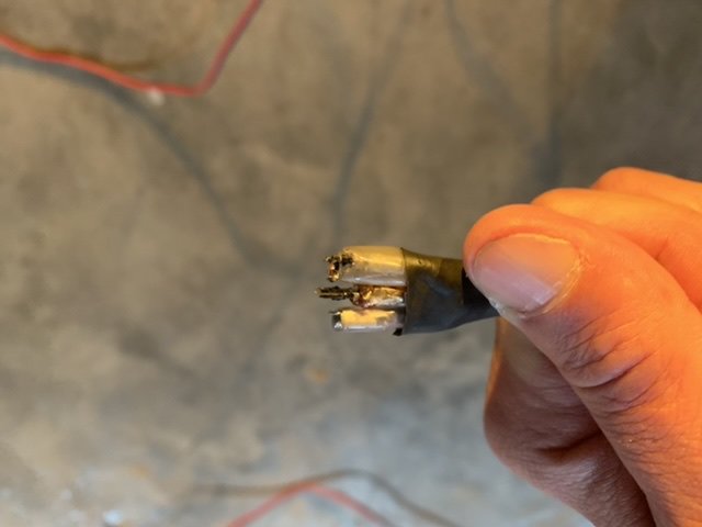

    With burnt wires I ripped that cheap ass switch off
  20. Nov 2, 2019 at 8:15 PM
    #80
    CLVol1255
    CLVol1255 [OP] Well-Known Member
    Oct 16, 2018
    #269644
    2,200
    Tennessee
    2017 TRD Sport DCSB
    Bilstein 8112/8100 ICON RXT Stage 2 JBA UCAs Archive Garage HH w Shackles Archive Garage U Bolt Flip kit Nitto Ridge Grapplers 255/80/R17 TRD Front Skid and RCI Transmission Skid Kenwood DMX 1057XR Head Unit Focal Utopia WM 3 way plus WM10 Sub Mosconi 5/30 and Genesis Dual Mono Amp
    The terminals were black of the switch
