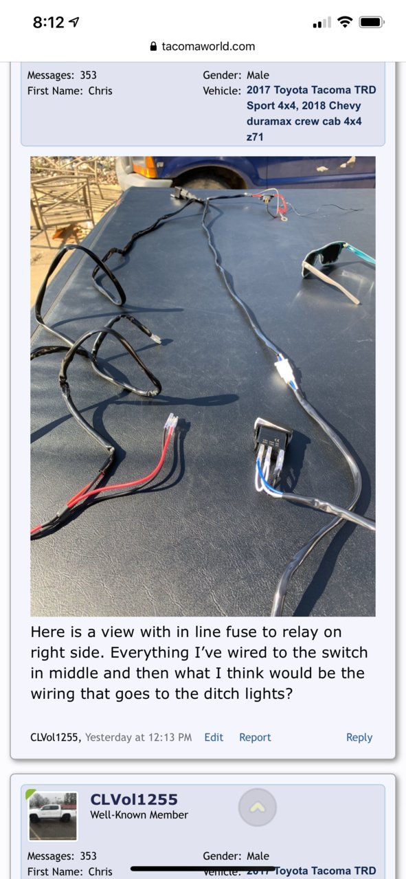

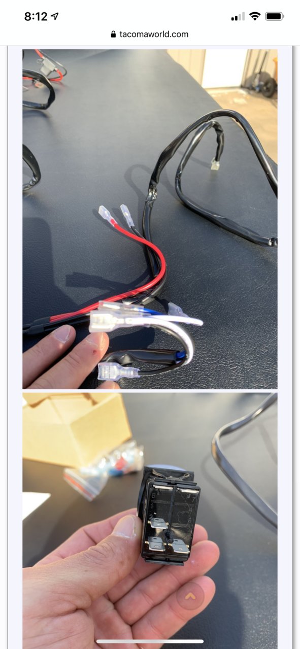

    I guess I don't understand the pic in post #43. What do all the male connectors go to? Did someone possibly take the relay out of the harness before it was yours? I would highly recommend bench building everything off a 12v battery in your garage before install. I went with a switchpro as I have minimal electrical knowledge. I would highly recommend it or something similar if you aren't a natural sparky.

    I’m not sure I don’t really know. I would like to think it wasn’t tampered with before it got in my possession. I honestly feel like I made the mistake not marking the switch negative terminal when taking it off to run thru cab although at the time I was sure I’d put it back on the correct way.

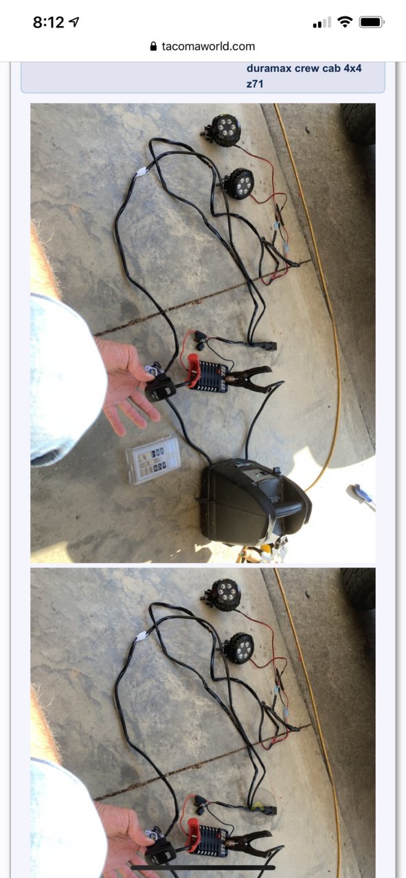

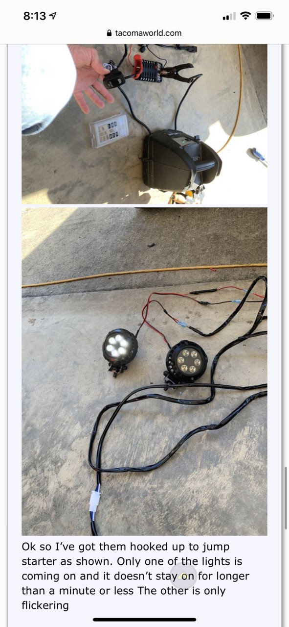

    Yeah it was my fault I’m 99% sure at this point. I’ve got the new harnesses in now and hooked them up to the lights ran it to my aux box and my battery jump box and one light is working but the other is not now. My light bar is working as well but they won’t work at the same time with both switches on. Both led lights of switch panels work one ditch light works when only that switch is flipped on but when I flip light bar switch on neither kc works? And vise Versa

    Sounds like there isn't enough juice getting through the aux box or battery jump box to the lights. If you try hooking them all directly to the battery through a fuse, they should all be able to turn on together. Try that and report back.
    Just make sure the wire gauge you are using is big enough to handle the load, and throw a smaller fuse on it in case anything happens.

    Another possibility is there is a wire crossed somewhere and the circuits aren't being completed as intended. Some lights turning of when turning others on is a symptom of this. I would suggest checking all the wiring and making sure it's plugged in where it's supposed to and that any ground connections are not done through a switch. A drawing would be most helpful here.

    oh wait, you're hooking it up to the jump pack. I don't know if that will provide enough juice for them all to work together.

    I think you’re right. I’ll hook them straight to my battery later and see if that makes a difference

    Everything came on and stayed on when I hooked it all to the battery on truck!

    Perfect, that just means the jump pack didn't have enough juice.
    Now just keep track of what is plugged into where (label them just in case) and run the wiring.

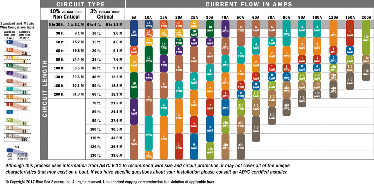

    Does it matter if my in line fuse is a 15 and the fuse in aux box is a 20? Also would I be wise to get a small circuit breaker to install or is that overkill for ditch lights and led bar for my Lower grill? Ditch lights are 40 watts and led bar is 180 watts. Thanks for your help

    You only need one fuse. Since you have a fuse in the aux box, you can get rid of the in line fuse completely. Just double check what the smallest wire gauge you have is, and pick a fuse based on that.
