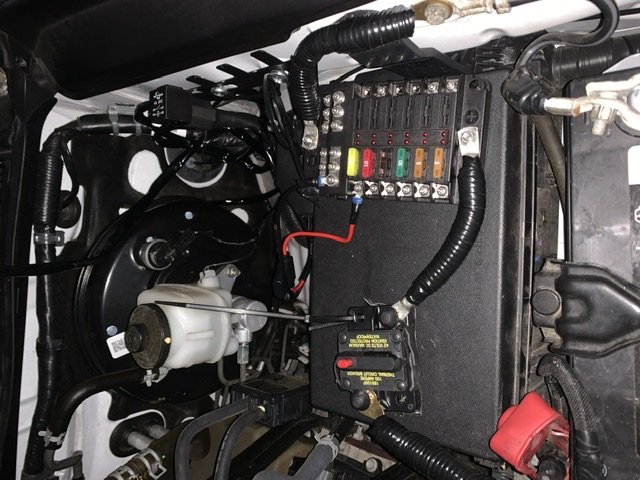

    My setup I also mounted a noco battery maintainer/charger on the passenger side behind the air filter casing. I also have new terminal with a 100amp in fuse block from blue sea ordered.. I ran 2 gauge awg from circuit breaker to battery and 4 gauge awg to aux box and ground. I probably overlooked conduit and heat shrink on the bigger gauge wires I ran but I wanted to be on the safe side. Thanks to this forum I was able to do this from reading and browsing the tons of information all across it. I love tacomaworld and thanks to you guys who have reached out to help throughout this thread... GO VOLS!!!!!!
