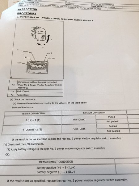

    random question....
    We are planning to wire up a rear sliding back window in the tacoma and will use this window switch from a 2017 tacoma.
    Anyone know what "E" signifies in the image? Also, where would the 12V+ connect?
    thanks
