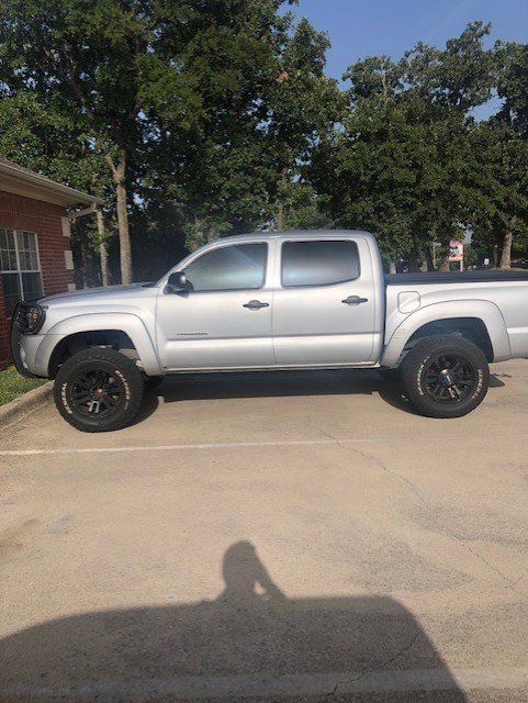

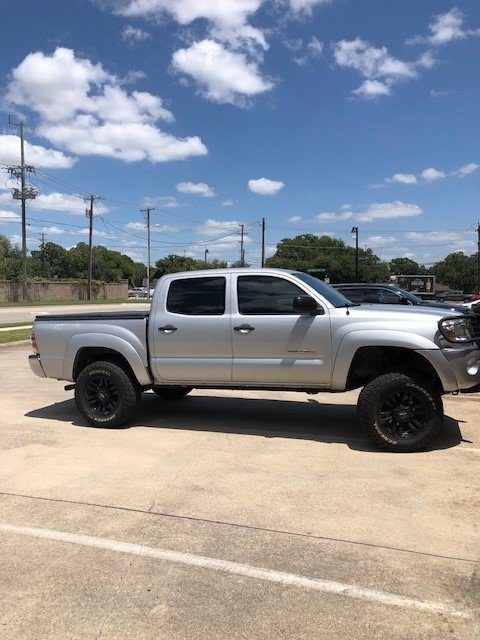

    Hi, I had my mechanic replace the front struts on my 2WD Tacoma. It lifted the front end almost 2.5 inches!! Mechanic is convinced at he put on correct shocks.
    Looks pretty goofy. Not looking to lift truck, just keep it level.

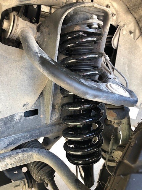

    new strut on truck.jpg The wheels are 6 lug.
    Unfortunately, the mechanic has the old struts or has thrown them away. Here is a picture the new strut on with the spacer.

    Looking at the photo of the truck that’s more than 2.5 “. Also the pic that’s shows the uca, is that with the truck sitting on the ground

    If this pic is with the truck sitting on the ground. You got way more than 2.5” of lift in the front. In this photo there is pretty much no down travel left. IMG_1919.png

    The picture of the uca is on the ground. The strut is sitting soo tall that my springs are hitting the upper arms.
