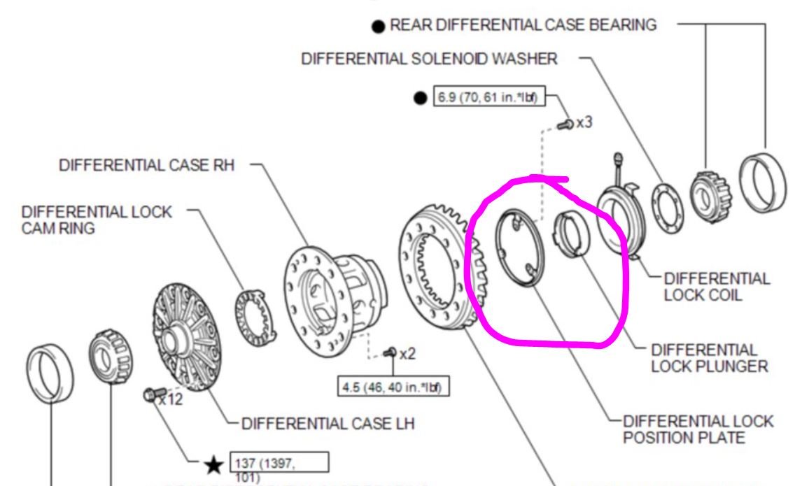

    As others answered already you have to install it from the other side. Did the same thing before. I plugged the hole and bypassed at ECU via switch, locker engages when button is pressed and with a flip of a switch it “tricks” dashboard indicator light and stays solid.

    I'm talking about the actual solenoid plunger. He's pushing on that with the sensor engaging the clutch. Which I guess he's technically just pushing the position plate which pushes the cam ring since those are what are bolted together as a unit.

    Ah got ya. We’re saying the same thing just using different words.

    Exactly. And I bet the "squeak" is the sensor end grinding against the position plate as it turns and the sensor holds the diff locked. :eek:

    That makes sense now. I wonder if the sensor was hit hard enough to move the plunger from around that ring, because it came out intact. What’s the process for removing the carrier to get the plunger in the right place? Did new gears just start to look a lot better?

    Undo brake lines, cap brake lines, undo backing plate, pull axles as far as they will go, unbolt third member, break insane FIPG seal, pull carrier.

    Drain diff, drive shaft off, axle shafts out just far enough, unhook wiring connectors, unbolt 3rd member from housing and pull out, unbolt carrier bearing caps (mark them), and pull out carrier. Then install the indicator and undo all you did.

    Just be really careful with the piece of wood. The sensor ring is thin stamped metal and is REALLY easy to bend. The ring on my diff wasn’t even true from the factory and caused an intermittent indicator light when the 5.29s went in because it was already closer to the pinion by an amount that wasn’t even visible to the naked eye. Every time the “bent” part was against the sensor when I parked I would get a flashing indicator light.
    Ended up having to mill down the mounting surface of the sensor to get the clearance we needed as no amount of trying to flatten out that sensor ring would fix the issue and I didn’t want to replace more parts!
