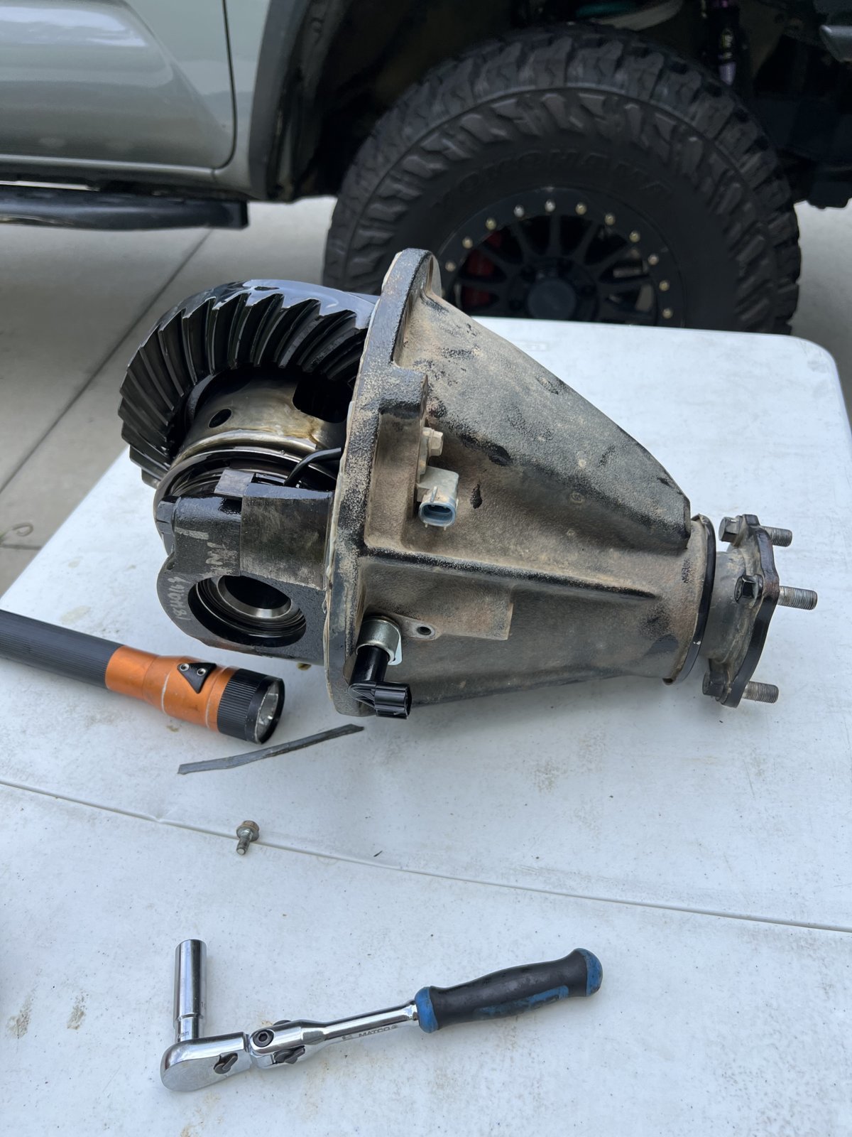

    Gotcha. Yeah I just pulled the 3rd member out and unbolted the caps holding the carrier down and lifted it roughly a 1/4 inch. Worked perfectly IMG_1268.jpg
