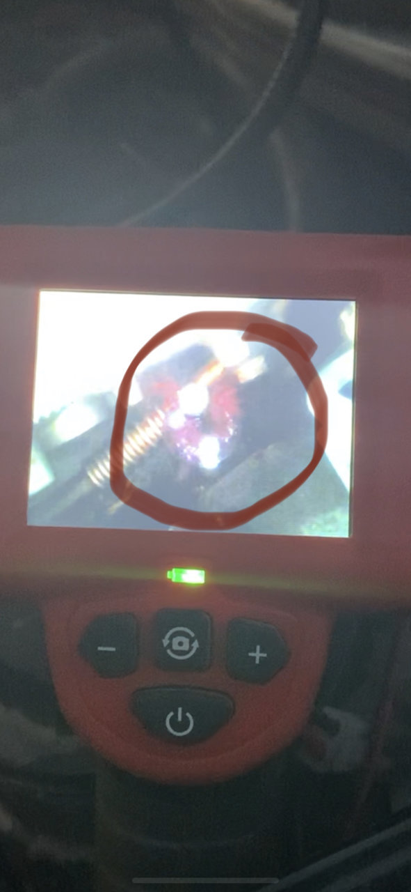

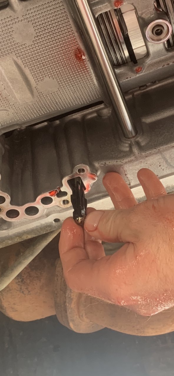

    Alright fellas, here’s the deal. I just finished the IPT transmission valve body upgrade. ( before I go on I must say that the John at IPT has been nothing but fantastic with his customer support, I do NOT blame them Them for this at all! ) After the first install I noticed transmission fluid leaking, I followed it up and it’s coming from the trans breather line. It only blows fluid out after a long sit time, 24hrs, and sometimes after engine shut off. When it blows out it will happen for about 3-10 seconds then stop. Maybe a 1/10 of qt at a time but enough to notice a puddle under the truck.
    I talked to John at IPT he said that I might have put a part in upside down( that part being a metal ball held by a black plastic holder with a spring ). After this conversation I took it back apart and reassembled it. While taking the valve body off the part fell out before I could see if it was installed incorrectly. This time around it is most definitely put back on correctly. After this second reassembly it happened to me again when I started the truck . After letting the transmission get to correct temp 115-130f I checked the fluid level and it was spot on, additionally the the fluid level was spot on the first time around.
    I have to let the truck sit for another 24 hours before giving it another try to see if it’s still blowing fluid, I will update this tomorrow and the following days.
    Does anyone have any ideas of what could be going on?
    pics below:
    It’s hard to see but you can see red fluid coming out from the breather line. It’s circled in red. The other pic is of the part that might have been out in up side down. 831D43E3-3E6F-41C2-A15E-C48894E0EEB7.jpg366C7B88-F374-41E2-9772-D046851536C3.jpg 160EEE81-E2AD-404F-8DA5-DB1153E3EA9C.jpg831D43E3-3E6F-41C2-A15E-C48894E0EEB7.jpg

    The issue is related to the Anti-drain back valve .
    The anti drain back valve prevents your transmission fluid from draining out of the torque converter and back into the transmission pan when you shut your truck off .
    Why is the anti drain back valve needed ?
    If your transmission pump had to fill your torque converter every time you started your truck , it would take a while for your truck to begin moving and we as Tacoma owners just wont stand for any delays .
    Let me do some digging in my manuals . I may have a fix for you
    1 thing that would be good to know ? Does IPT change anything in the valve body to effect the drain back circuit ?

    Your issue deals with the anti drain back valve not performing as it should operate .
    This issue is not a common problem with the A750 Series transmission and this makes your problem very difficult to diagnose over a keyboard considering a valve body was just installed and you never had a vent leak before the IPT valve body was installed
    I would suggest using the technicians assistance at IPT try and help you out , rather than removing the valve body again .
    Those guys have a multitude of employees .Mondays and Fridays come into effect . 1 missing check ball in that valve body is all it would take to create a problem such as yours .
    Do they check the drain back circuit during a valve body shift test ?
    Considering you already had the valve body off a couple times , its time to let the boys at IPT try the valve body on a good working A750 series transmission for verification of proper function
