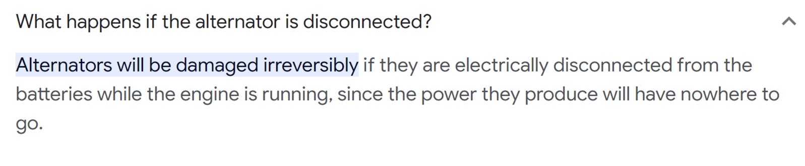

    Found this online before trying your suggestion:
    I may just take it out the alternator and bring it to Autozone today to be tested

    You don't want to unhook the big wire off the stud but on our trucks unplugging the connector with the engine off or running will simply remove power from the regulator and field coils essentially turning it off.
    Now yes on some vehicles you don't want to do this as it could damage things.
    Also if it's a bearing in the alternator failing unplugging it may not remove the noise.
