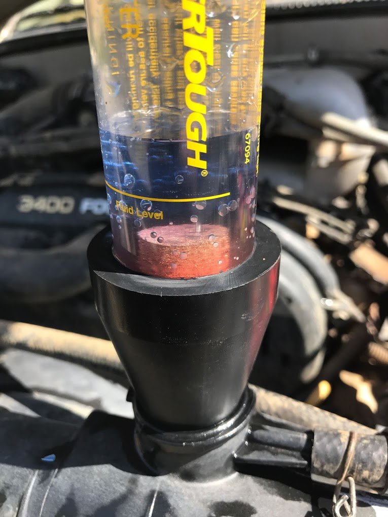

    1st...you can also rent an exhaust gas detector at your nearby chain autoparts store to double check that exhaust gasses are not bypassing your head gasket and going into the coolant.
    It looks like this. If there exhaust gasses it'll turn yellow.

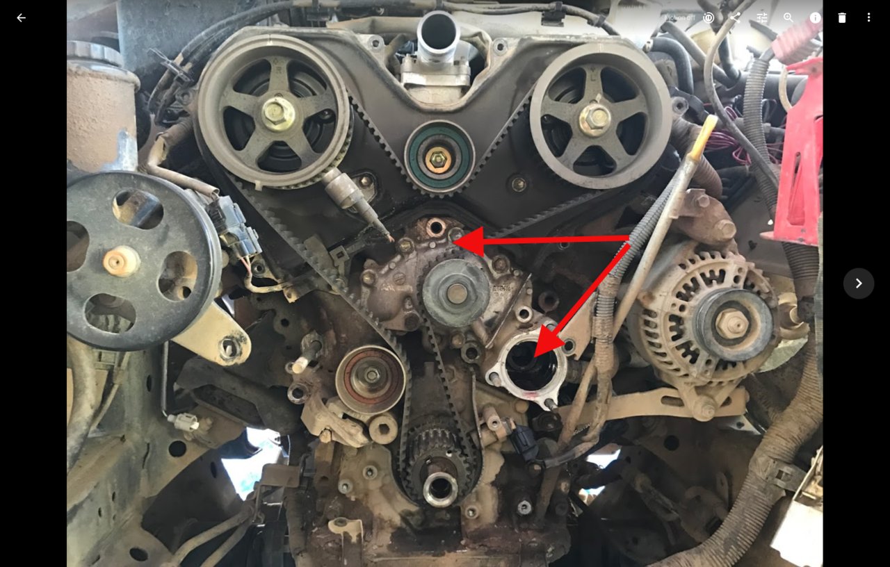

    It's not all that hard.
    You gotta remove the fan, fan clutch a bunch of pulleys, timing belt cover and lower radiator hose, and maybe some more to get to it. While your in there if your timing belt is getting older you might as well replace that as well.
    The red arrows point to the water pump. This is mine either putting it back together or taking it apart.
    When I replaced mine last spring I also replaced all my AC components. My compressor grenaded. It's a lot easier when the bumper, grill, condensor are all off the truck. Also letting all the air our helped.
