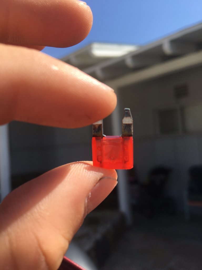

    turn signal uses its own fuse

    Supercharged, AEM FIC/6, Meth Inj, ION Alloy's, Radio & Phone steering Wheel controls,Fabtech AAL, Billie's wrapped with 880's , Tundra big brake conversion, bully bars and Pioneer DDin Stereo/dvd with exterrnal usb ports. 290K and going strong.
    if you don't have a test light yes pull them out. theres a little wire in the middle. if its burnt you'll see it.

    image.jpgThere's a separation in the wire looks like I found the cause....

    2004 Tacoma 3.4l Extra Cab
    The haz fuse is good. So looks like that's the culprit I'll have to go grab a new fuse. Hopefully that's it! Thanks for all the help @mechanicjon appreciate it man!
