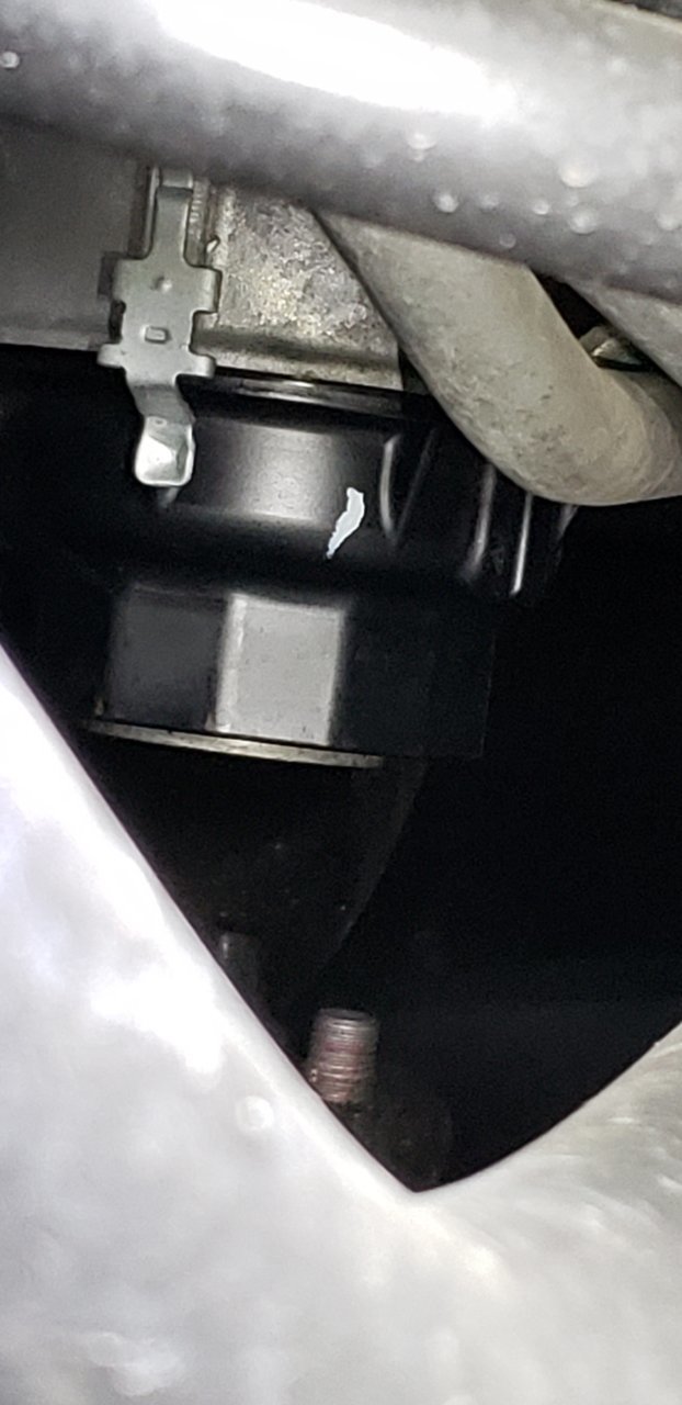

    If he used hand tools and put over 60 ft. lb. of torque, he's a goddamn moron that should not be changing oil. I believe being a dumbass that used an impact wrench is more plausible and forgivable , (I'm told that new techs don't like hand tools by a buddy in the business). I drove it about 50 miles, let it cool about 30 min. What do you suggest?

    Grab an impact and try to tight the cap. Report back what happens to it.

    No, I try to avoid doing dumbass things. Seems like it would work, you would just have to be careful to not over tighten. Also seems like repeated use would be hard on the plastic. Am I missing something? Tell me what would happen.

    The plastic tabs break off, leaving a hole in the filter housing, causing an oil leak. Some may even call it an oil spray if you crank it :crapstorm:
    And for anyone assuming, no I didn't install mine with an impact. I took it off with an impact (because it was too tight for even a 1/2 breaker bar...). Replaced it with aluminum housing knowing it was gonna be toast once I gave it the beans.

    i failed successfully. I broke a tab off my plastic one, but it didnt leak :anonymous: replaced it with an aluminum one the next oil change. Now i tighten the housing till it bottoms out, no tighter.

    This is the spot on filter cap where you should end up around with 18 lb-ft. Should be pretty much the same spot each time.

    FYI, it will give you a fight at the next oil change even after you torque to specs.

    True story, mine was so stuck on that my ratchet extension twisted when i was wrenching on that housing.
    i have one of those nice oil filter wrenches and eventually i decided my best option was to use my m18 impact.
    buzzed it right off, same way the dealer put it on im sure….
    Edit: more backstory, the center of my motivx tool got pretty wallowed out trying to wrench the housing loose. I also tried breaking it loose with a hammer and punch but from how it felt from tapping on it, i could tell they just slammed it on with an impact and only an impact was going to get it off
