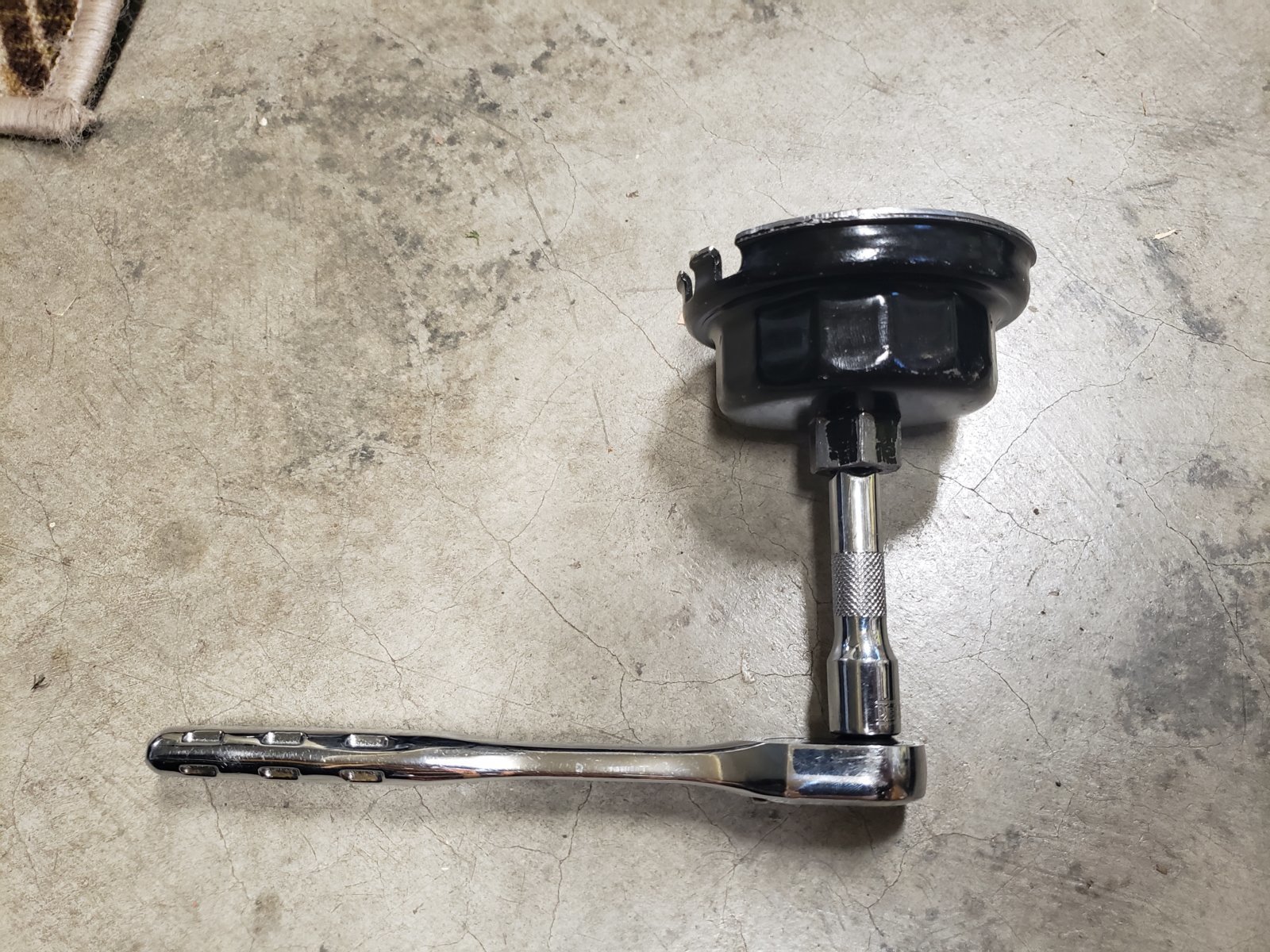

    any tool that touches those fins is not a good one, thats where they get cracked

    Disagree. It works fine
    I use this setup to take off on 2107 tacoma and 2012 toyota for many years now.

    an important step :thumbsup:
