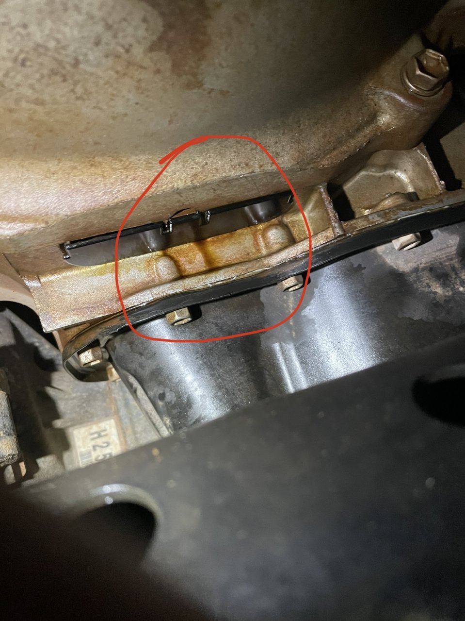

    Hey all. I just saw an oil leak all over the bottom of my truck. I narrowed it down to a leak above my oil pan. Can anything tell me what this part is called and where the oil is leaking from? I added oil and got my truck up to temp and saw oil dripping down from the black part but I’m not sure what that is. Much appreciated in advance.

    The black part is just a dust cover, the oil is likely leaking from the rear main crankshaft seal.

    It requires the transmission to be removed so yes it can be depending on labor rates in your area, you should be able to remove that black plug and see the seal to verify it is indeed the seal leaking.

    I’m pretty sure you’re correct about the RMS. I saw the oil dripping out from the black plug

    If everything is dry above the bellhousing then pretty much the only place it can be coming from is the RMS or upper oil pan gasket, seal is more common than the gasket.
