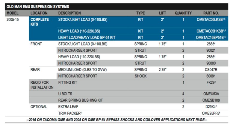

    I'm currently running 885/billies 5100 and the standard Dakar leaf pack. I called my local suspension shop and told them I wanted to replace the OME 885 coils with 887 coils.

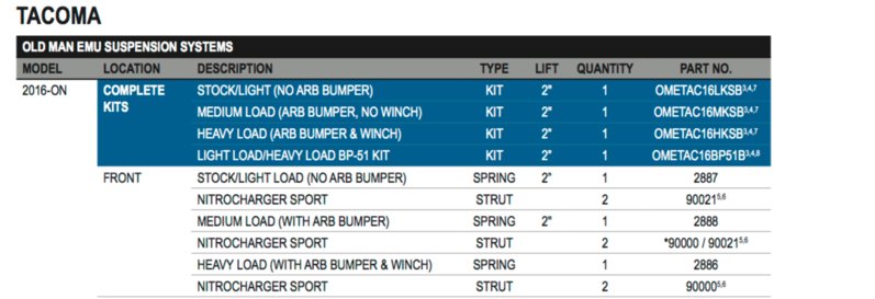

    The response I got is confusing me. I'm told the ARB website doesn't list the 887 for the 2015 and that it's only listed for the 2016 at 2" of lift.
    Can anyone shed some light on this for me. I know a lot of people on this forum are running the 887 coil on the 2015 so I'm not sure why ARB wouldn't list them as working on the 2015.

    2015 Tacoma here. I run 887's with a top plate spacer, aluminum bumper and Warn M8000 with synthetic line - about 90 extra pounds up front over stock. It gave me just under 3 inches lift and rides great. Expect about 2 1/2" with no spacer and stock front end. The 887 is "not tested" by ARB but will work just fine - spring load is the same as the 885 but with an extra half inch or so of coil length.
    That extra 1/2" of lift will probably limit your ability to get the truck properly aligned with stock upper control arms.

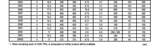

    Happy to help. I noticed that there is now an 888 spring listed as well. It's 5mm longer than the 887 :muscleflexing: but all other specs are the same as the 885/887. I don't recall seeing it as an option when I fit my 887's, might have been introduced for the 2016s. :notsure:

    888 is brand new for 2016s, it's essentially the 2016 version of the 887.
    You don't see the 887 for a Tacoma because it's a 4Runner coil.
    The 887 is a 2" coil on 2016s because the 2016s are an inch higher than the second gen trucks, so every coil/5100 setup is an inch shorter on those trucks than they were for the 2005-2015s.

    Actually that 5mm (not 0.5mm) will translate into an additional 10mm or ~1/2" of lift.

    ARB quotes 2" if you look at the chart above.
    Edit: That's with bumper, so probably 3"

    I thought the chart was for the 2015's

    lower chart with 887/ 888 springs says 2016

    Oh ok thanks, yeah I'm looking for a 2 inch lift on my 16' pre runner so I'll probably go with the 887's on 5100's
