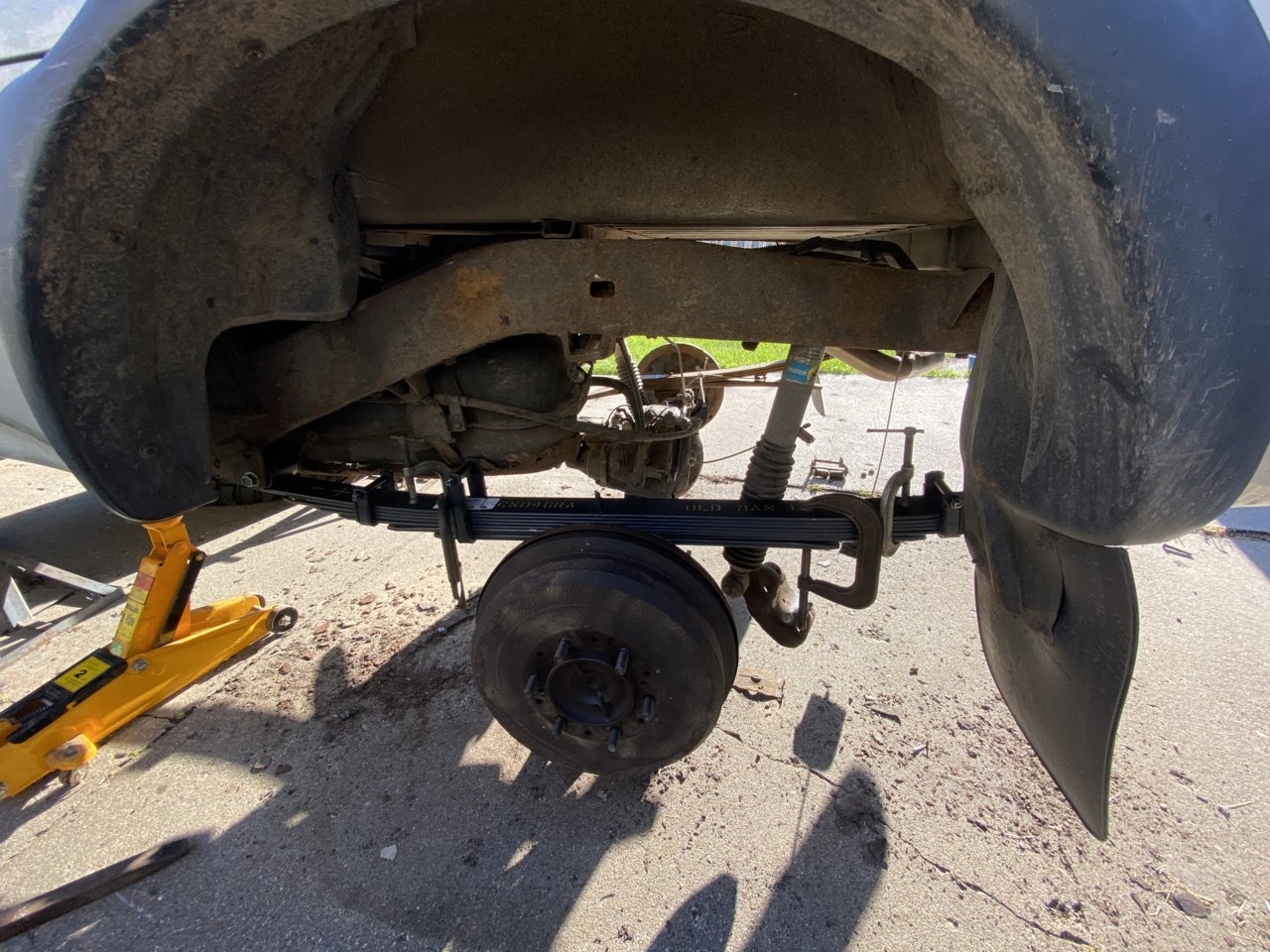

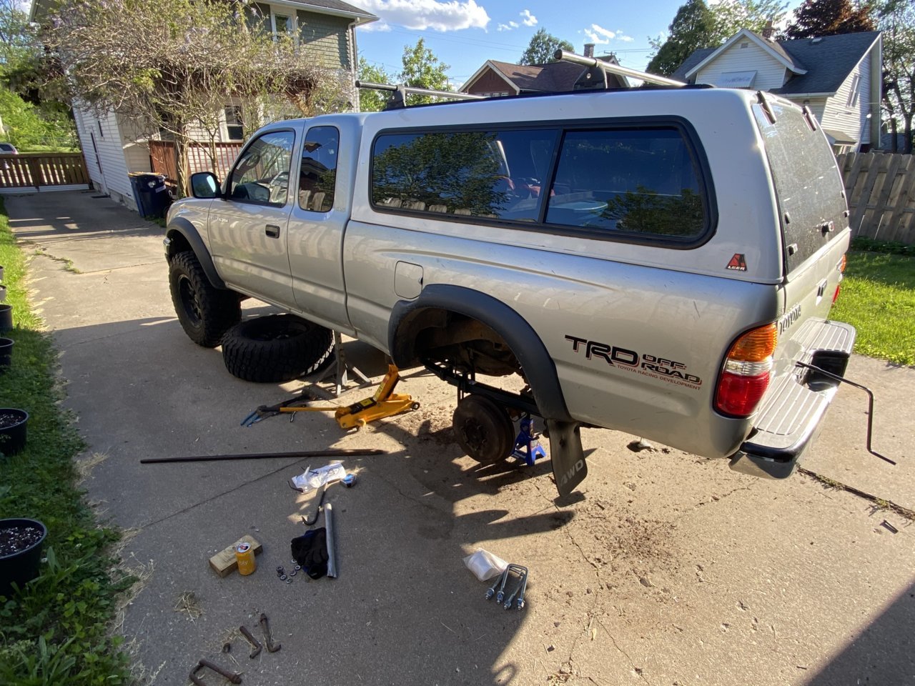

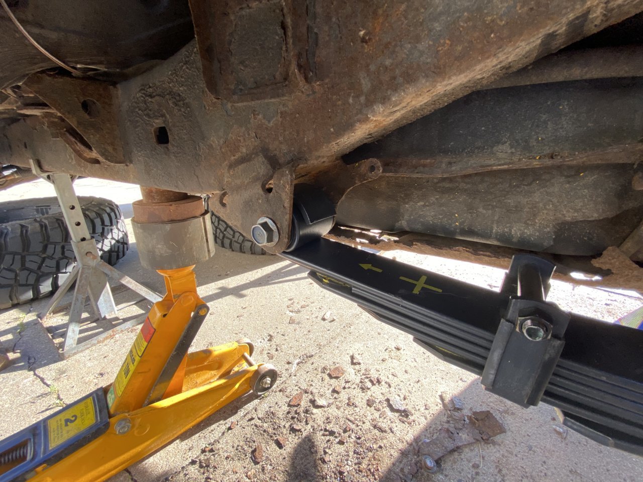

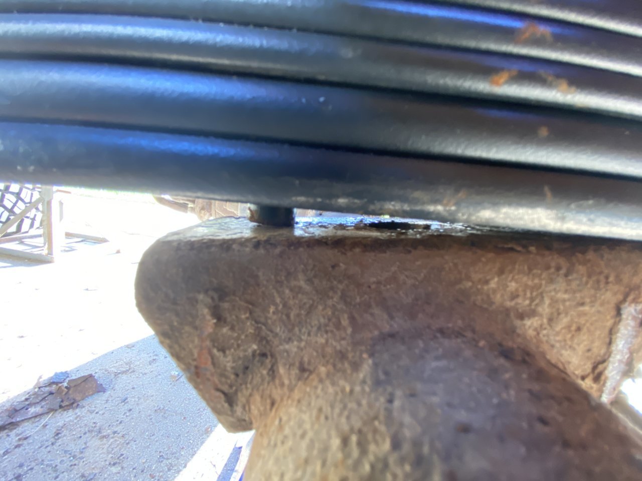

    So I finally sawed and hammered and swore my stock leaf springs off my 2002 TRD so I can install my new OME Dakar’s. Should be easy enough, right?! Just take off the old ones and put in the new ones! Nope. Not lining up. At least an inch off and I have the springs nearly flat with c-clamps. Correct direction, correct leaf spring for the drivers side. What gives?!!! Help!

    I had to use a ratchet strap to persuade everything to line up. I'd recommend giving that a try if you have one laying around.
    Edit: I am curious why you put the C clamps on the leaf spring. What's going on with those?

    2019 Tacoma TRD off
    Yes most of the time with diffs and leafs You need to force things up.

    '04 3.4 tacoma, '16 4.0 4runner
    Shackles in the rear ?

    Use some muscle for the pin and leaf pack :notsure:
    If you have an issue with the bolt on either the front eyelet or rear shackle, just use a ratchet strap.

    I had the same issue. You have to guide the axle to align it with the pin. We had to loosen the other side.

    You just manipulate the leaf pack to align on the pin, it's that easy.

    You have the other side all loosened up?

    @jayvp77
    Looking back at your pictures, you didn't lift your truck from the frame high enough to let your rear axle droop.
    You don't want the springs flat, you want them curved otherwise you've built up tension in your leaf pack.

    My major problem was cutting the bolt out of the spring hangers.
    On all the springs on Toyota 4x4`s I did I hung the spring first then installed the spring seat .
    By having a floor jack under the axle housing moving from side to side as I tightened things up
    Snugging things to it was all on the ground till the final tightening .
