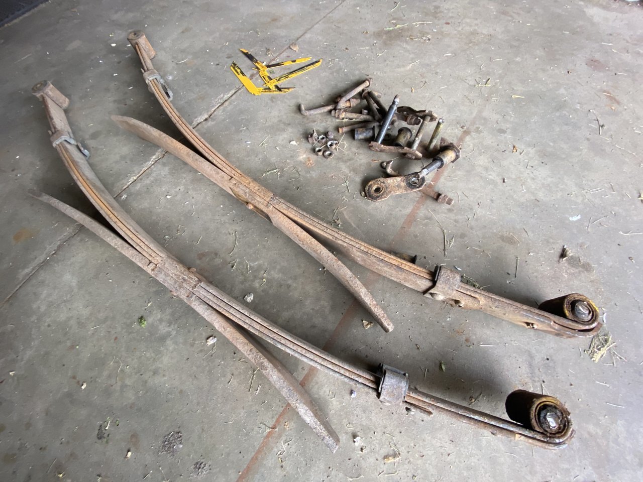

    Partially. Need more sawsall blades to finish the uninstall.
