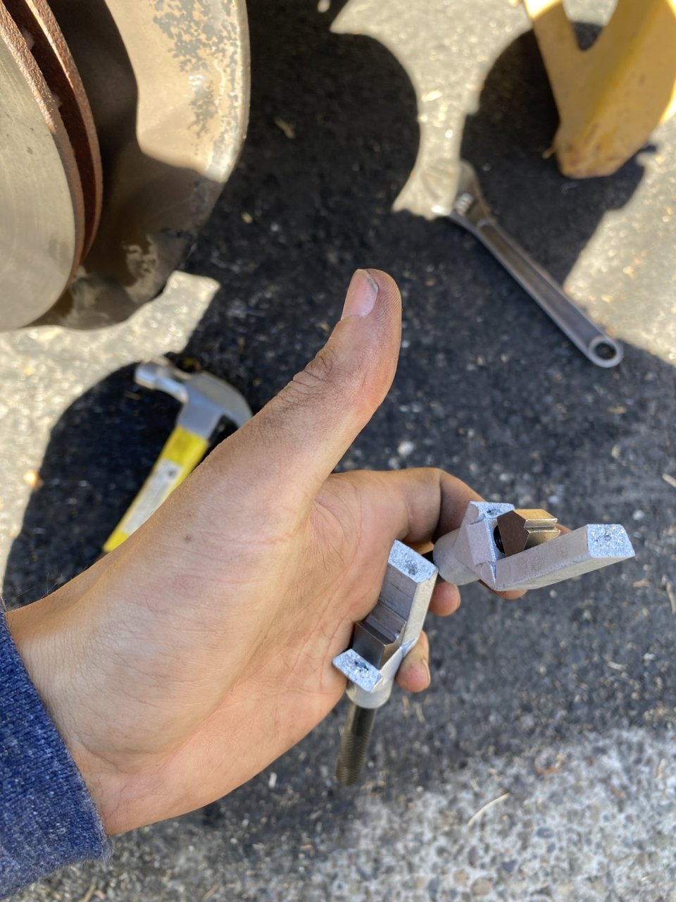

    Nastyray
    Nastyray [OP] Member
    Aug 16, 2022
    #403712
    16
    1998 toyota tacoma
    None
    Check this

    Trying to separate a ball joint or something?
    What's going on with the suggested fix of simply using a socket and wrenching off the extractor bit?

    I honestly wanna know what socket he would apply to the extractor? I mean yes that is definitely the way to go but my brain is just not picturing what socket to use.

    Ah didn't realize it was one of those bits; was at work this whole time.
    I'd use locking pliers or something on it. An adjustable wrench like he has is supposed to be used but I always fear they round off anything they touch.

    Yeah if there is one tool I hate its vice grips/locking pliers they round stuff off for me. That looks like a 3/8 in square end on the extractor. A crescent wrench wont hold up for sure.

    A tap wrench isn't going to work for this... as you found out. You need an eight or 12pt socket of the appropriate size.

    Is the extractor at its largest diameter bigger than the hole itself?
