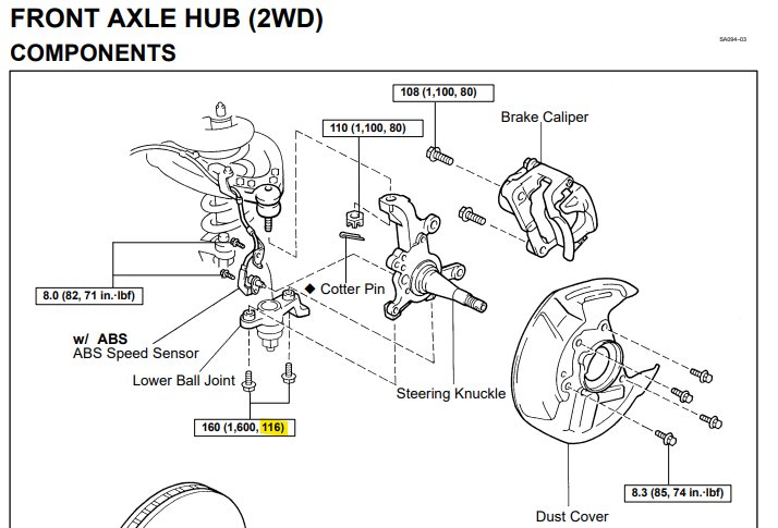

    I also just looked at the FSM for the 2wd.. Those bolts are speced at 116 ft lbs. Just to give you an idea of what you're trying to overcome with that extractor bit.

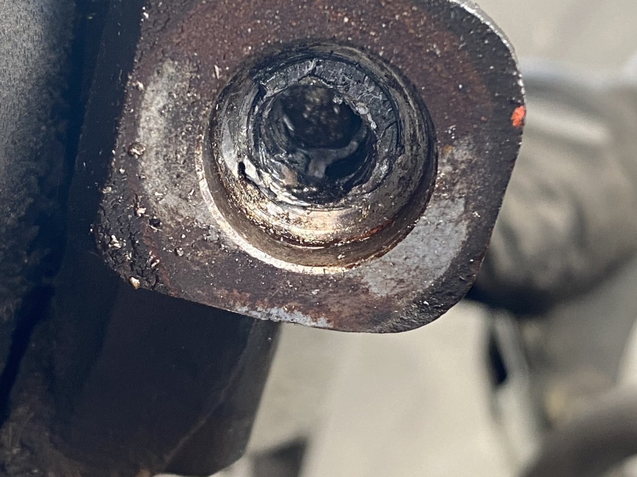

  15. Aug 29, 2022 at 10:58 AM
    #75
    Nastyray
    Nastyray [OP] Member
    Aug 16, 2022
    #403712
    16
    1998 toyota tacoma
    None
    Thanks for all the information
    I’m Back at it
    got my hole in the bolt back..
    I been PB blasting a lot.
    169F184D-5DF7-42A9-A027-D289F06BD304.jpg 169F184D-5DF7-42A9-A027-D289F06BD304.jpg D75FC736-013B-4EF5-8892-3124E4B1282E.jpg D75FC736-013B-4EF5-8892-3124E4B1282E.jpg
  16. Aug 29, 2022 at 11:00 AM
    #76
    Nastyray
    Aug 16, 2022
    #403712
    16
    1998 toyota tacoma
    None
    Extractor out :) D48AFCFB-14D1-499C-86BD-A3682BD6FF20.jpg
    Cland75, 0xDEADBEEF and Kwikvette like this.
