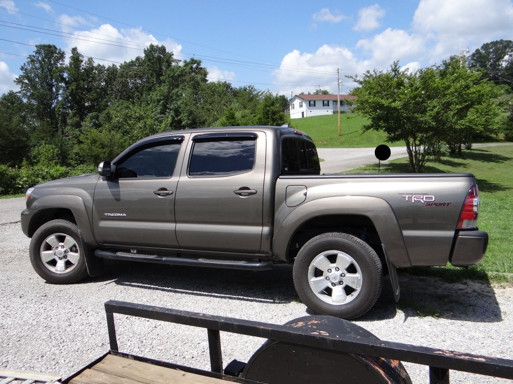

    I had the time to kill today so I went ahead and did it.
    Before:

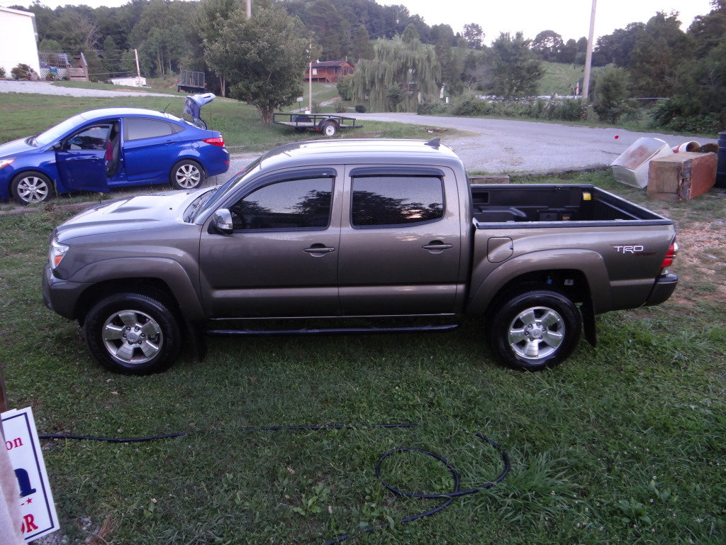

    After:

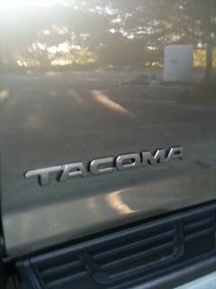

    I removed and color matched my emblems. Hated the chrome and everyone is doing black. Really like it, they kind of disappear and show up again depending on the light and angle. Havent seen anyone else with a pyrite and color matched badging yet. Sorry to add another option.

    How did you match the Pyrite? Where did you get the paint?

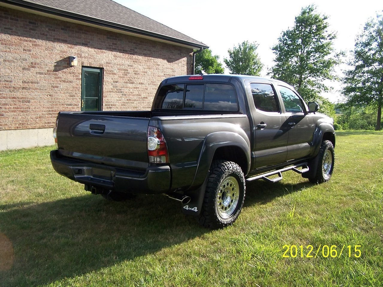

    that looks sick! what size tire is that?? :) :cool:

    265/70/17 Duratracs on 17x8 et10 (4.9" bs) wheels. 5100's set to .85.

    You can order the paint from automotivetouchup.com. I tried to include a link for you, but their server is down for maintenance. They were quick and easy to order from.
    Do a search and you can find good instructions on removal and re-application. Mark the locations with blue painters tape before taking off if you are re-applying. I took them off, scuffed them with a scotchbrite pad, 1 coat of adhesion promotor, two coats of base, and two coats of satin clear. Biggest pain in the ass is putting them back on. Get the 3m trim adhesive tape and some sharp exacto blades. Apply tape in one strip and use the blades to carefully cut around letters (this method doesn't allow dirt to get behind letters)
    It is basically an all day job, but it is a pretty cheap mod and it looks good.

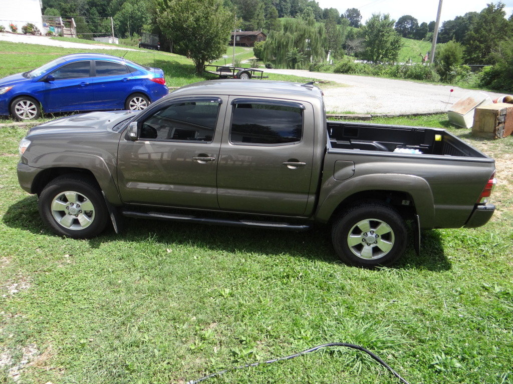

    Update: I went full on and took stickers off too. Here she is mean gleen and coppery green.(I had a guy call my taco coppery green today, somehow it stuck)
