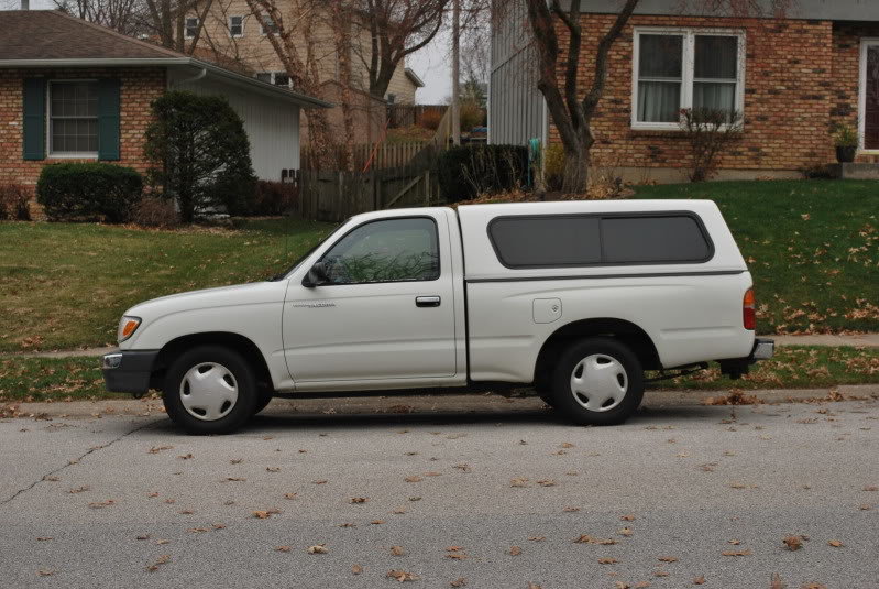

    Well, I got antsy and went ahead with this little project today. Pretty happy with the results!
    The bed liner produces a black line on the outside. A little "different," but it doesn't bother me much.
    The other side. I really wish my new headlamps would come in the mail… mine are fogged as hell.
    Here's a view that shows the interior. Quite happy with it! I just cut out taller holes where the tie-down holes were, you can see the clamps in the corners. I had to run and grab some longer bolts since the liner was further-out horizontally from the bed rails.
    Damn you Des Moines! First week I moved there, someone gifted me with a hit-and-run. It's only thing that really marred the appearance of the truck.
    Now I just need to figure out how to hook up the taillight to the camper shell, and I should be pretty well set. The shell uses a 3-pin plug, while most aftermarket parts are 4-pin... might have a lot of wiring to stuff underneath. :(

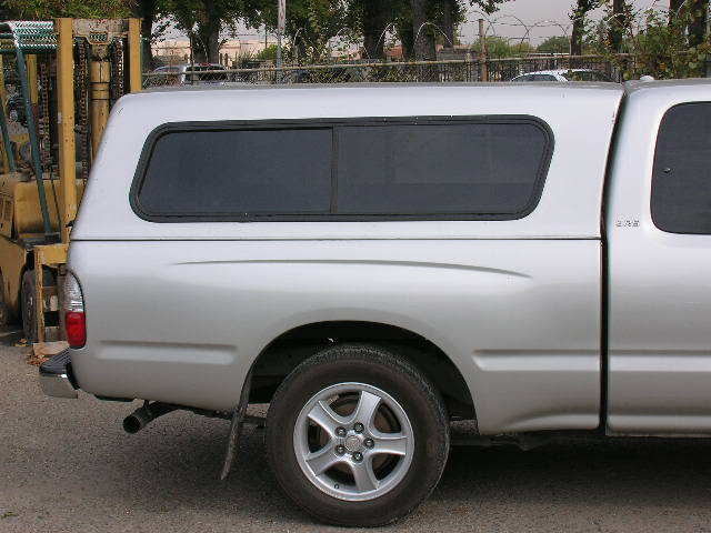

    could you get a side shot in the same profile as this one?
    I'd like to show people that there is a difference in extended cab vs standard cab camper shell designs..
    thanks :)

    your truck should look exactly like mine, my truck is an extended cab..
    the regular cab trucks on the backside of the cab don't have as much angle to them..
    If you used an extended cab shell on a regular cab truck, you'll be about 1/4" away from touching, one good speed bump and your in the body shop..
