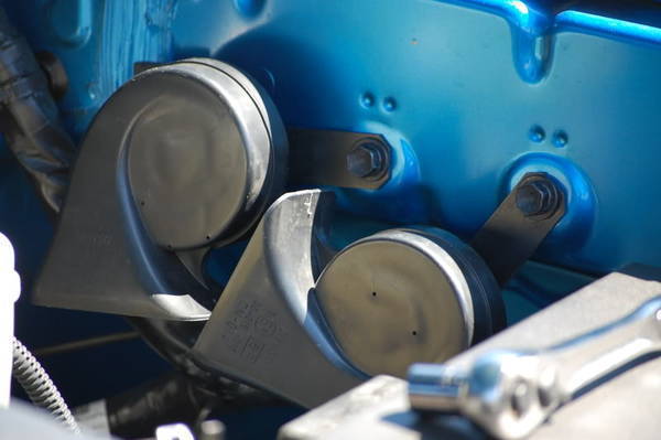

    I've done quite a bit of searching and haven't found a solution to this. I just did a satoshi and wanna relocate my horns now, however, the standard location to do so.....

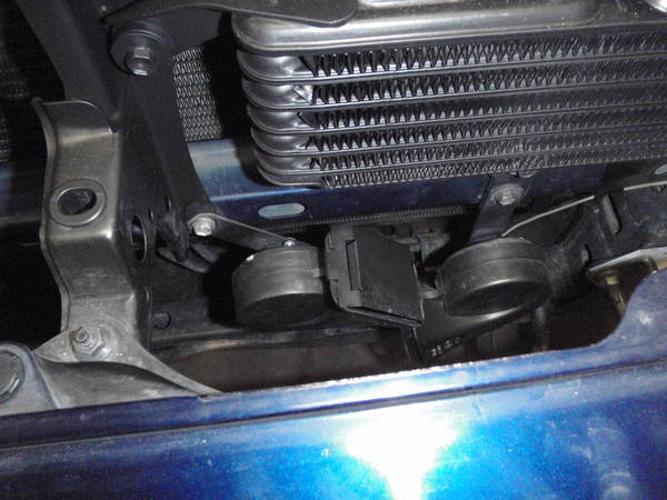

    isn't an option because the intercooler pump for my SC sits there....

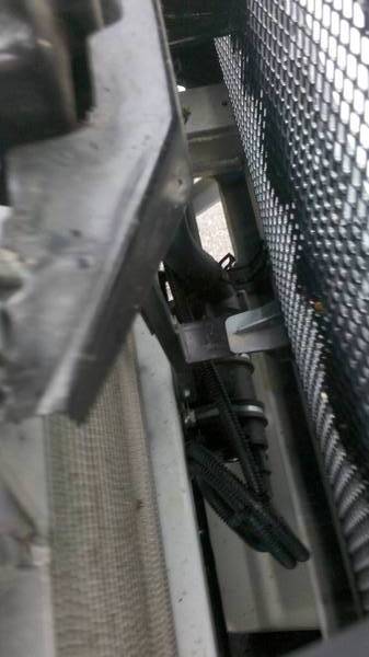

    But I can't do that either, more SC apparatus:
    Anyone with a SC and satoshi have any info on where I might move those things? Thanks, WTB

    try looking up inside the front bumper behind the fog lights. I think there is a bracket or 2 up under there you can mount them to...

    trying to revive this....still haven't found a spot, I looked up under the bumper, none of the threaded holes fit the horn mounting bolts

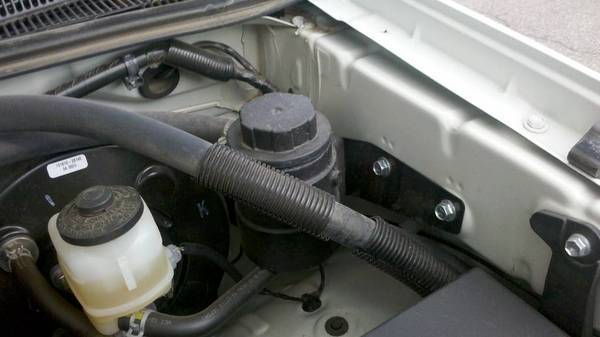

    You guys know what size bolts and thread are used for the interior hood side mounts? Installing some supermarket electronic stuff and would like to know before buying.

    If your talking about the two holding the horns in the pic above, which are located on the side wall behind the battery and fuse box are 8mm (M8) x 1.25 pitch

    Thanks much.... you are correct. All is going well now on my project.
