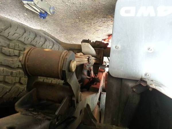

    Old vs New :
    Can't wait to get this all finished up and see how much better my truck will be.
