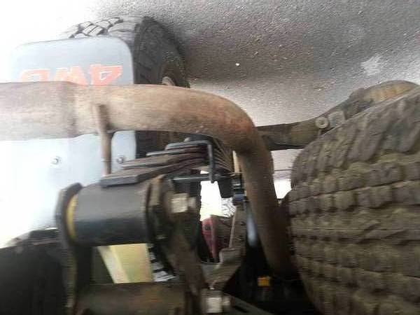

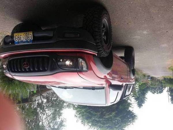

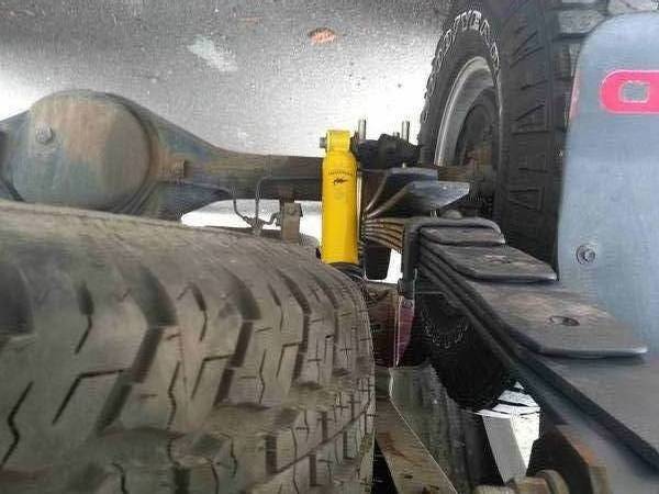

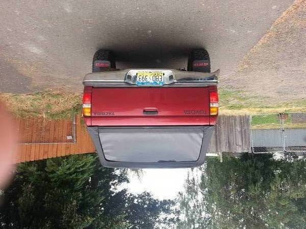

    Alright Here are the pictures; Everything look ok? Did I mess anything up too bad?
    Side Shot :
    Passenger Side :
    Driver Side :
    Shot of the back :

    The leafs are upside down. So is the rest of the truck.

    FIXED! :thumbsup:

    I think it looks fine, except the lack of bushing on one side of the shackle is troubling (at least that is how it looks). I know you had some issues with this. Are these Dakars? And who did you get them from? I think you should double-check with the vendor to make sure they did not accidentally short you a bag of bushings. Every leaf eye shoud have two half-bushings, and each shock eye should have two half bushings. Is that what you ended up with?

    Yeah I hear ya. I was worried about that as well but didn't know what else to do. I don't see it doing damage or messing anything up too bad for the time being until I can correct it, do you? They are Dakars, and I got them from Down South Motorsports. It's not really what I ended up with because I couldn't get both halves in the leaf eye, they were too long to the point where there wasn't even any threading showing on the shackles with both halves in. and the shorter ones ( the ones I used for the shocks ) were a different thickness that wouldn't even fit in the leaf eye, but fit in the shocks. So I decided to just go with the way it is now even though I knew it was missing/wrong since I didn't see any other way they could possibly go with the parts I had.
