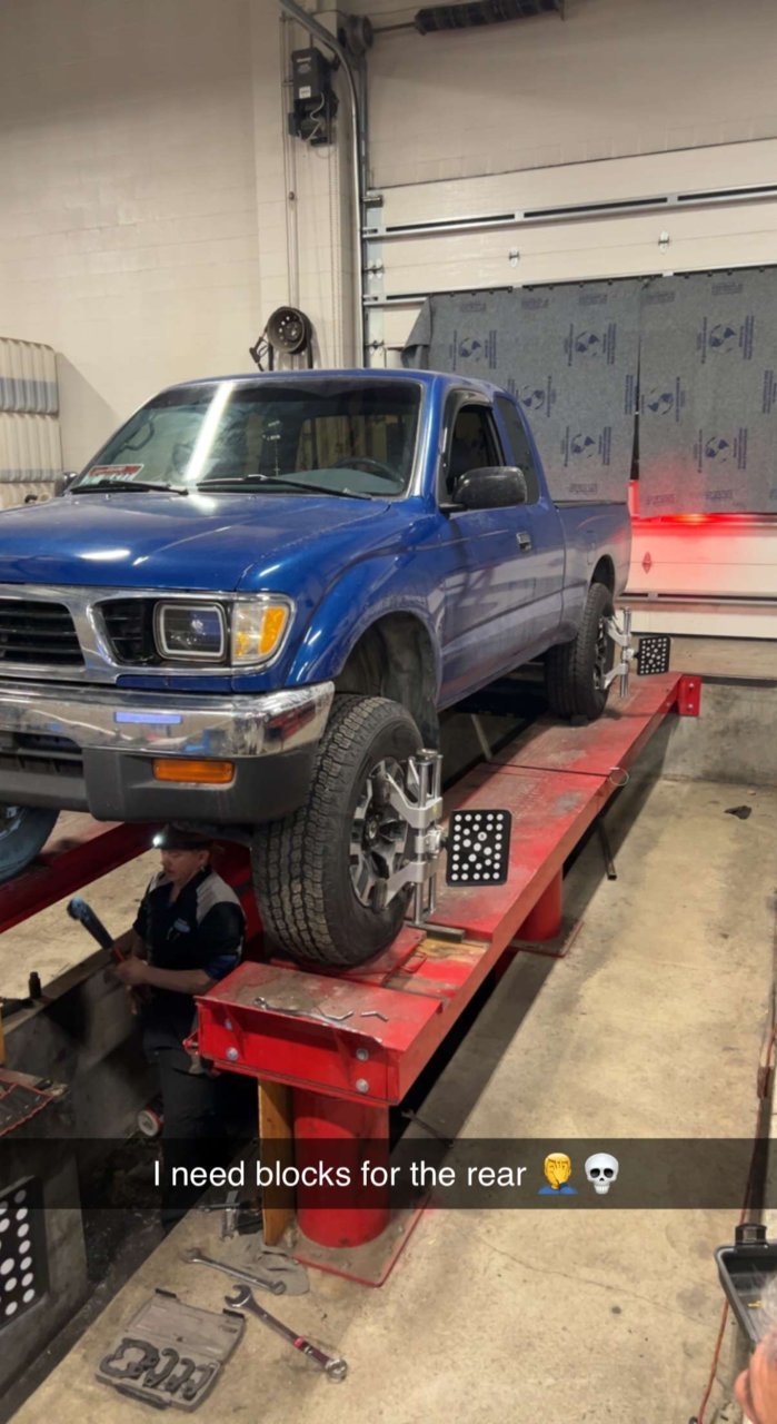

    I used ran my 03 Tacoma with the -19mm 15” pro comp street wheels with a 32/10.5R15 bfg. I ran into a few problems with it. I had to shave around 1mm out of my calipers and remove oem side step. It clears everything other than the side step.

    Repainted, wheels and tires, halo lights, sound system, tint
