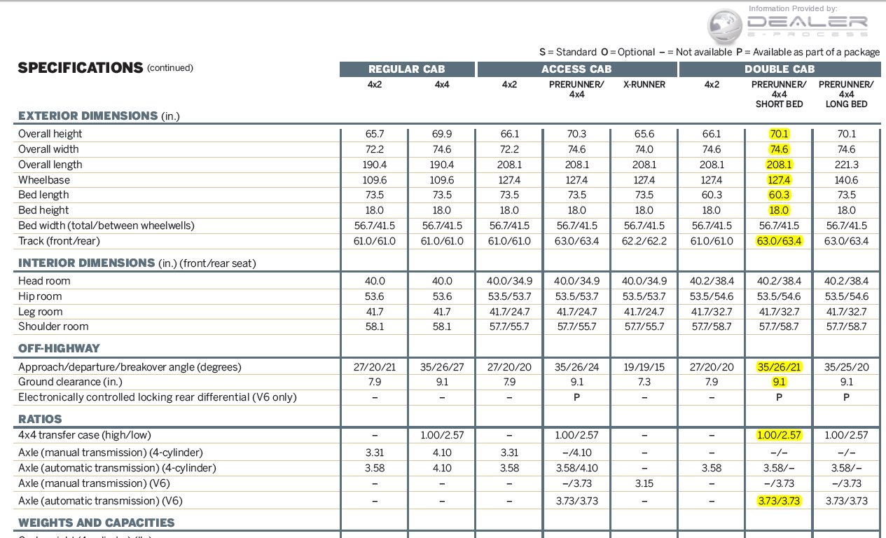

    FYI that thread is for 1st gen trucks. Cant find the one for 2nd gens right off
    But the below screen shot is from the 2012 brochure

    Looks like 2nd gen 4x4s are all 3.73 unless it's a reg cab with 4.10s
    If it is a gear ratio issue with the OPs truck then it's likely the PO regeared the rear, or he picked up a reg cab 4.10 diff? The latter seems less likely but possible I guess
    edit - never mind there's also 3.58 option, didn't read the chart fully lol
