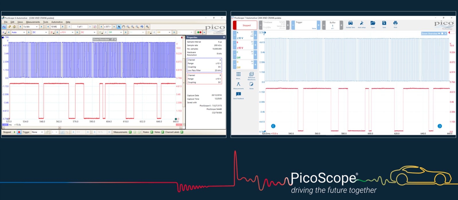

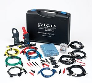

    I don't know about you, but this is what we are required to diag electrical and some driveability concerns. Scopes. If we use a Fluke they can bounce the claim. Ihave a little training with it but still use my Fluke and an 1157 bulb.
