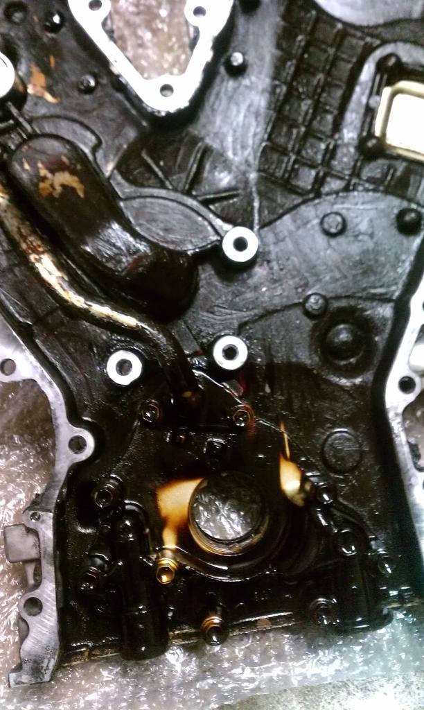

    IMG_2175.PNG.jpg About every 8k miles. I'm the second owner, I bought it in 2010 w/72k miles. Still had original spark plugs, not sure how well it was taken care of by original owner.

    Yikes, that is some nasty looking oil. Glad the trucks ok now. Good luck OP.

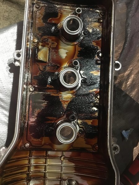

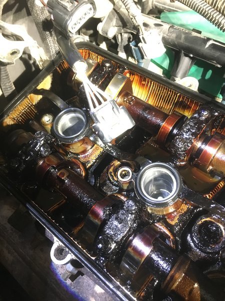

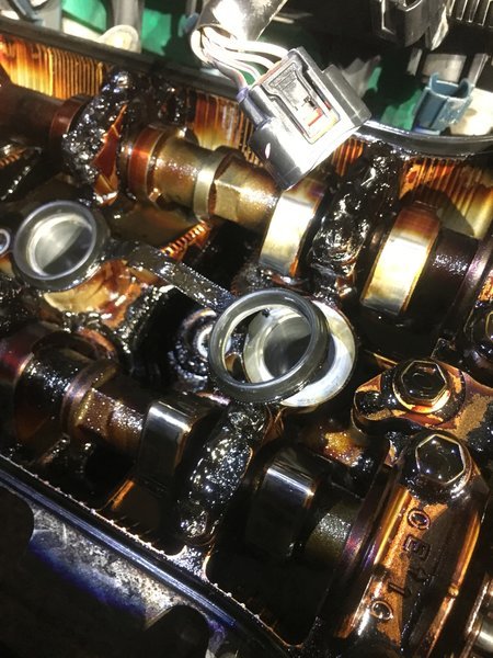

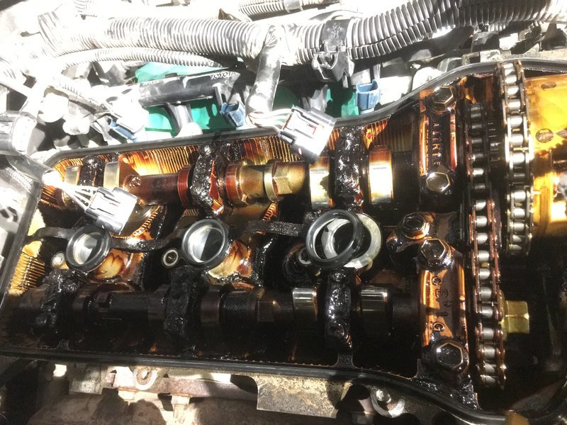

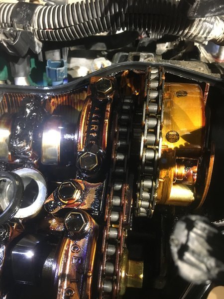

    IMG_4408.jpg IMG_4407.jpg IMG_4406.jpg IMG_4404.jpg IMG_4403.jpg So far....

    No1 lifter well was dry on top, no oil in it like the rest.

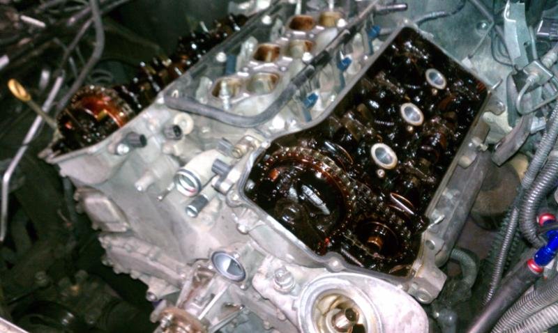

    We also borescoped through the sparkplug sockets, nothing alarming there. Wipe and clean, replace v cover gaskets and run an engine flush with something?
    I was going to pull the oil pan to see if there was sludge that neeeded to be cleaned out. Wondering if I should wait until after flush to do so, if you guys recommend a flush. My fear is breaking up more sludge and causing damage. I've never had to flush an engine before. Never had one that I expected to last 300k+ miles either.

    There is only one "good"way to remove sludge. Disassembly and manual cleaning.

    I think a lot of folks do that but these trucks are expensive new especially for younger guys just starting out. That said, OP saying original plugs at 70,000 miles is a dead giveaway that original owner neglected the truck. I hope it works out for him...

    :facepalm:to the previous owner's maintenance.
    They called it. Oil pick-up tube, probably has a very small opening which isn't clogged.

    Reminds me of when a used engine of mine looked like this.
