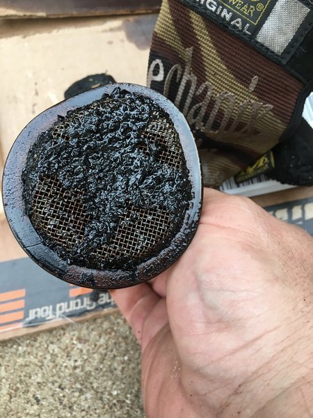

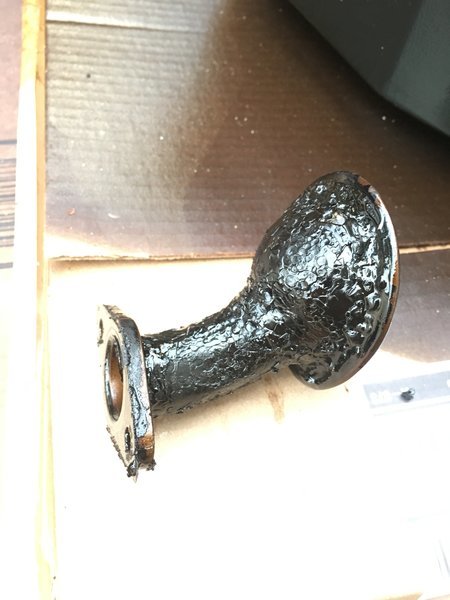

  4. Feb 5, 2017 at 3:23 PM
    #44
    txtuffluck
    txtuffluck [OP] Well-Known Member
    Apr 25, 2011
    #55543
    249
    Johnny
    Central Texas
    07 TRD OR, V6 4X4
    IMG_4417.jpg No.2 oil pan looked like a big raccoon took a shit in it. Forgot to grab a pic, but it was approximately a two inch tall pyramid of gunk. Here's a pic of the pickup. Looking through the bottom, things look surprisingly good.IMG_4414.jpg
  5. Feb 5, 2017 at 3:49 PM
    #45
    Torspd
    Torspd Tor-nication
    Sep 18, 2009
    #22958
    26,299
    Tor
    The Great America!
    MMVI 4.4L 4x4 Access Cab
    Torspd Custom Turbo kit [] Borg Warner 9180EFR Turbo [] Haltech Elite 2500 [] TiAL Q BOV [] TiAL V44 Wastegate @ 15psi [] CP Pistons [] CP Carrillo Rods [] ARP Head studs [] ARP Main Studs [] ARP Header - Head Studs [] Ported Heads w/ 1mm oversized valves intake/exhaust [] Brian Crower Forged Stroker Crank [] Darton M.I.D. Sleeved Block [] Kelford Camshafts [] Torspd 160* T-stat mod [] APR Large Fuel Rail [] Walbro 460 LPH E85 Fuel Pump [] FueLab FPR [] APR T56 Conversion Kit [] KP RACING Built T56 [] McLeod Racing Custom Twin Disk Clutch [] One Piece Aluminum Driveshaft [] MGW Shifter [] Custom lowering kit [] Ohlins Front Coilovers [] QA1rear shocks [] Custom Ron Davis Radiator [] Dual SPAL Electric Fans []
    #Extendeddrainintervals.
    Looks similar to what mine did. Mine spun bearings after a miss shift though. You're luckier.
    On each head. Towards the timing cover. Exhaust side of heads. There is a bolt which houses a filter. Remove those as well to inspect.

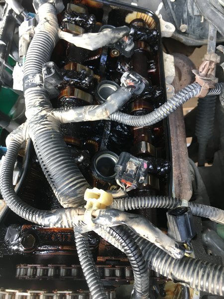

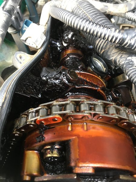

  7. Feb 5, 2017 at 4:02 PM
    #47
    txtuffluck
    Apr 25, 2011
    #55543
    249
    Johnny
    Central Texas
    07 TRD OR, V6 4X4
    We're drinking beer and debating cleaning valvetrain, no2 oil pan, and pickup as best we can. Sealing it back up, running Amsoil engine flush, and super short OCI's for a while.
    Or pulling the engine and then cleaning/rebuilding.
    Problem is time and money. It'll take a few weekends thanks to work. Which means I'll have to drive this to/from work and park this in a parking lotIMG_3080.jpg

  9. Feb 5, 2017 at 9:17 PM
    #49
    Jimmyh
    Jimmyh Well-Known Member
    May 16, 2012
    #78991
    14,206
    SC
    2012 Prerunner SR5
    The bad thing is you can never tell when a small chunky piece is going to break off and clog a return passage and fill the area under the valve cover with oil or even block the oil pickup again... I guess as long as you know going in and run frequent OCI's with flushes it could work out OK... Time will tell.
