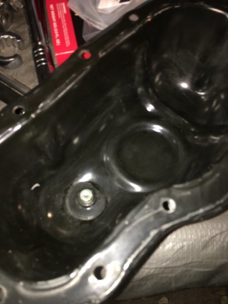

    Once everything is cleaned and bolted up, clear the codes and drive around for a day or two. If the code(s) come back, I wouldn't chance it. Otherwise, I'd be on my way and hope for the best.

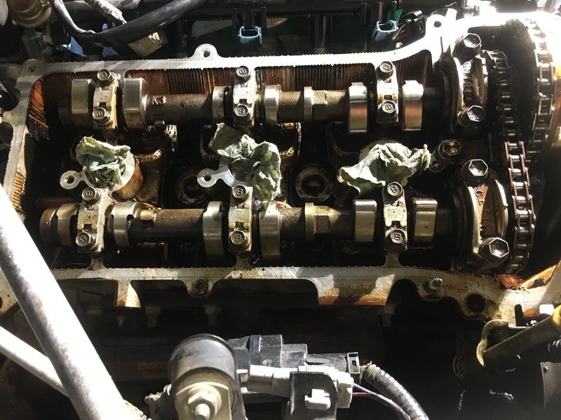

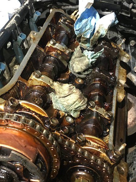

    Progress with kerosene, a paint brush, a nylon brush, and a shop vac.

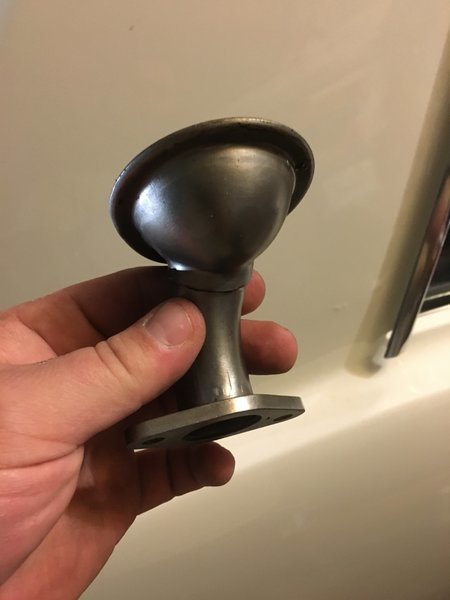

    F%#k this driver side OCV filter! Can't get the filter out....tried shopvac, dental pics, screwdrivers, needle nose

    Still a lot of progress.

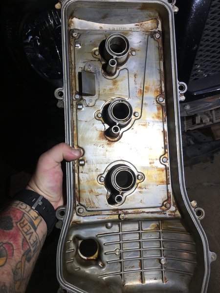

    This was caked and looked like an oil covered desert floor.

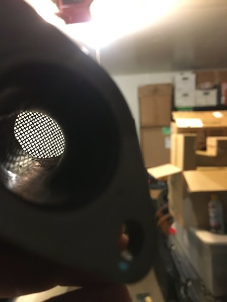

    Torspd Custom Turbo kit [] Borg Warner 9180EFR Turbo [] Haltech Elite 2500 [] TiAL Q BOV [] TiAL V44 Wastegate @ 15psi [] CP Pistons [] CP Carrillo Rods [] ARP Head studs [] ARP Main Studs [] ARP Header - Head Studs [] Ported Heads w/ 1mm oversized valves intake/exhaust [] Brian Crower Forged Stroker Crank [] Darton M.I.D. Sleeved Block [] Kelford Camshafts [] Torspd 160* T-stat mod [] APR Large Fuel Rail [] Walbro 460 LPH E85 Fuel Pump [] FueLab FPR [] APR T56 Conversion Kit [] KP RACING Built T56 [] McLeod Racing Custom Twin Disk Clutch [] One Piece Aluminum Driveshaft [] MGW Shifter [] Custom lowering kit [] Ohlins Front Coilovers [] QA1rear shocks [] Custom Ron Davis Radiator [] Dual SPAL Electric Fans []
    Dayum. Sucked the mesh in.
    Have you pulled the filters on each head yet?

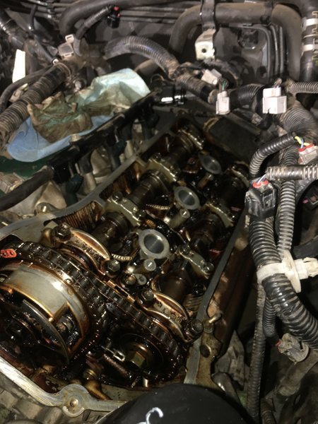

    Got the passenger side pulled and replaced. Just got the driver side pulled.

    Dirty, and some crusty stuff, back 1/8" of filter was still clean.

    Truck is back together. Test driven, no codes on the dash or Ultragauge. Engine seems to be running quieter, steady 190.4 degrees Fahrenheit, nothing leaking. 4.5qts of Castrol dino and 1qt of MMO. Will try to put 50-100 miles a day on the truck, change oil and check no.2 pan every 1,000 miles, 3 more times.
    Thanks for all the help and I'll keep everyone updated.
