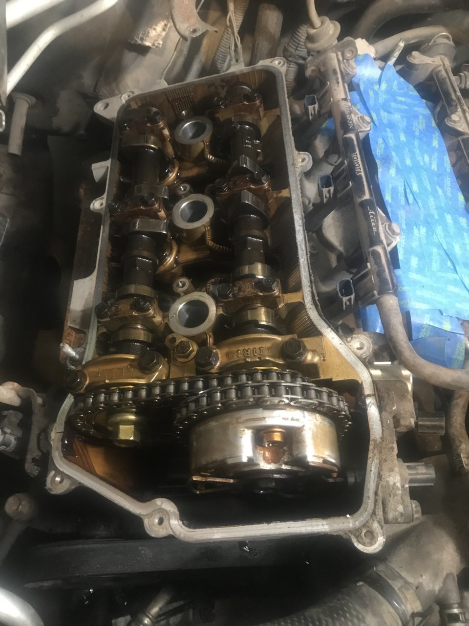

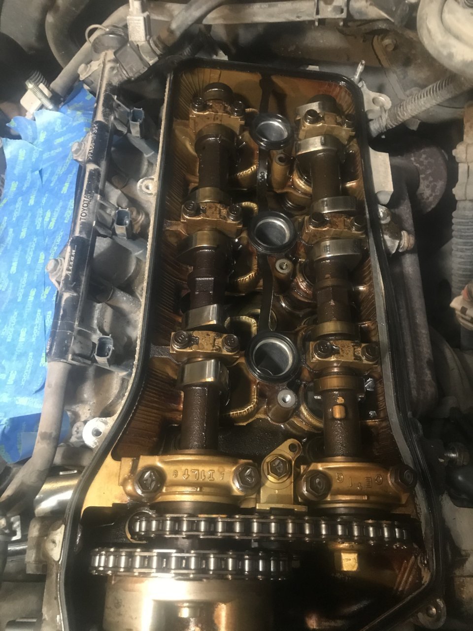

    I pulled the oil pan and found no sludge whatsoever and the screen in the oil puller tube was clean. I tested the oil pressure and found it was 70 psi while idling in N and was 60 psi while idling in D or R. I exposed the view port to the tensioner and it did not seem to have moved at all. There was no indication the chain had stretched.
    I pulled the valve covers and there is some buildup but doesn't seem horrible. Let me know. I am going to check the timing marks tomorrow.

    That actually looks quite nice in there. That's a good sign.
    Based off of the oil pressure that you witnessed, it could be that the sensor is faulty.
