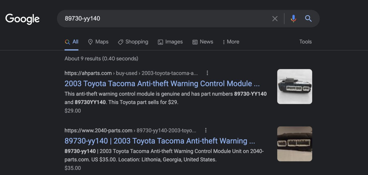

    I’m in desperate need of Part Number
    89730-yy140, Anti Theft Warning Module. It’s for a 2003 Toyota Tacoma Pre Runner Extended Cab 3.4 Liter. I’ve literally searched online for days with no luck.

    I tried that one and I received a message that it was outdated and unavailable.

    Pull your unit; it'll be an RS3000 or RS3200
    Have seen them come up in the used section many times for cheap
    Bet you can find it in a junkyard too and even Ebay; several Toyota models use the same module

    Yeah, I saw that one also. I have get where my headlights work if I short it out. May continue with that before I spend $500 for the part right now.
