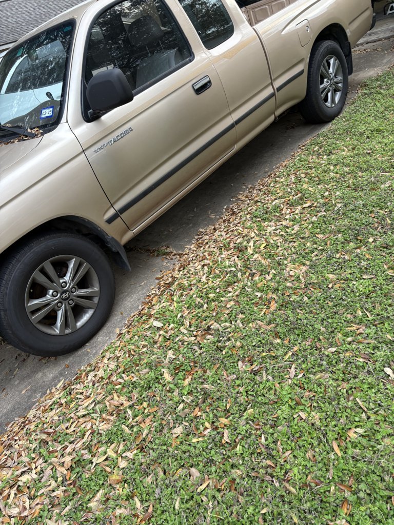

    same driving as you

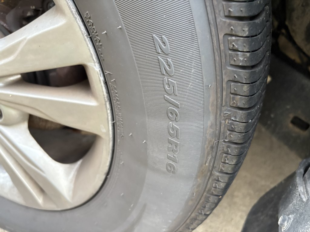

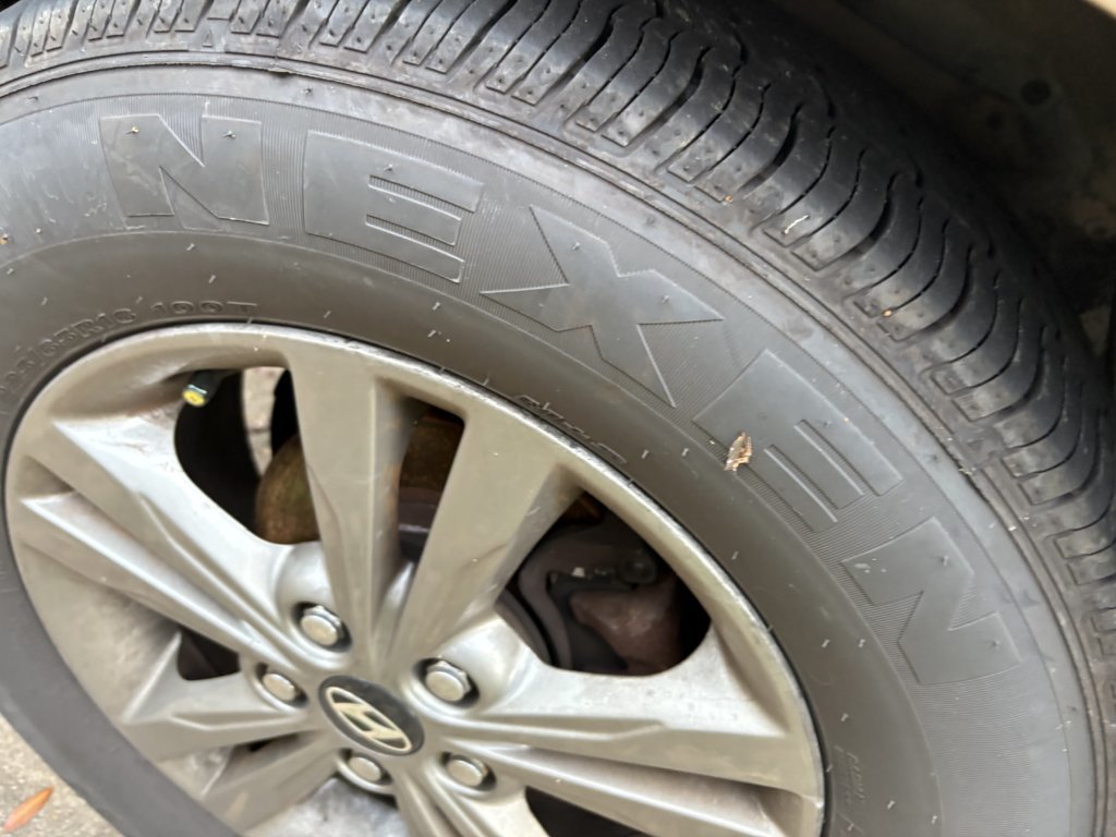

    Clock Volt meter/LSPV Delete/Hyundai 16’s/FP gauge/after 9months of wrenching ZERO oil leaks
    100% less than $100 per shoe
    Not even a glimmer of rubbing/clearance issues

    2014 Sonata rims
    And(too my surprise)
    Center caps cleared the taco’s 5lug grease caps!!!!
