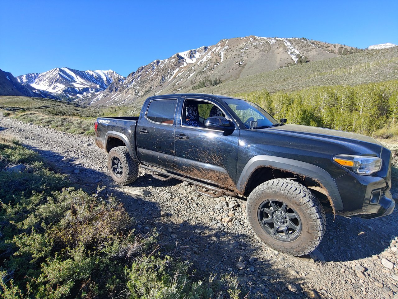

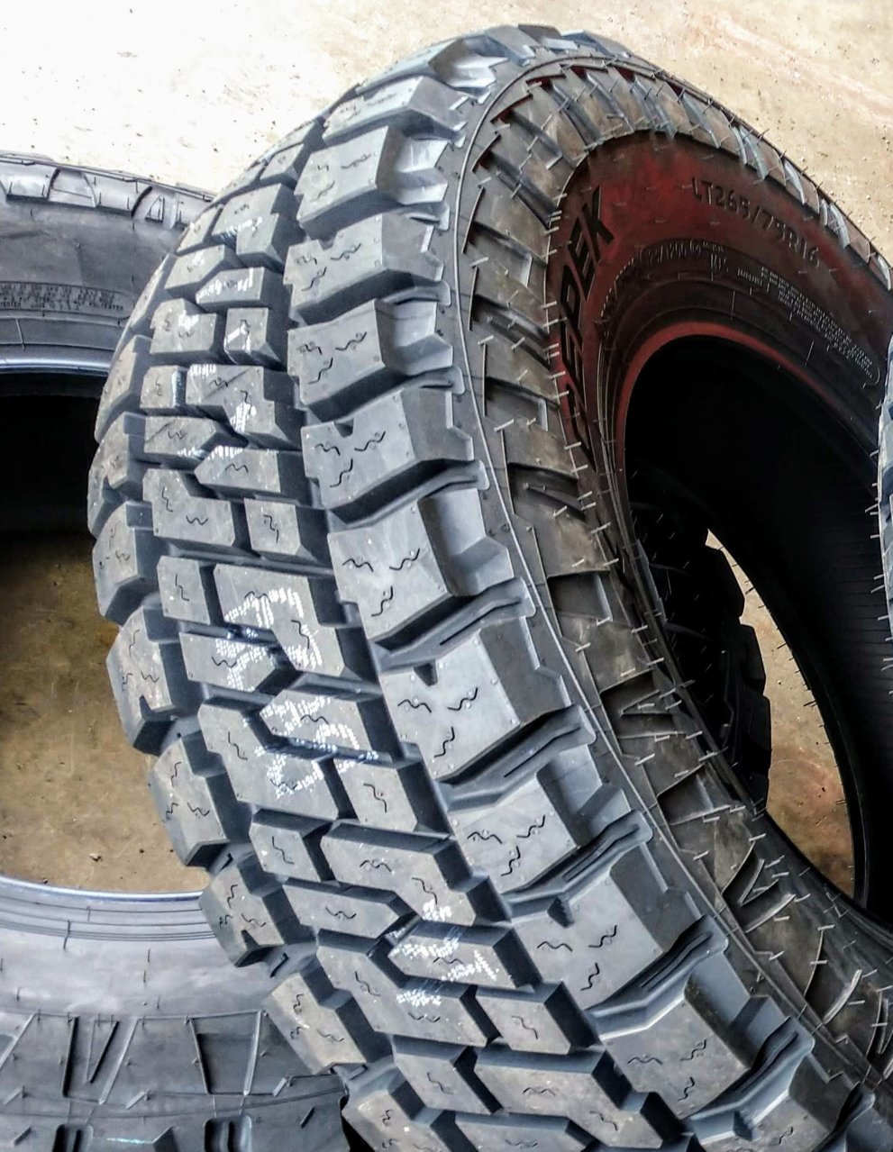

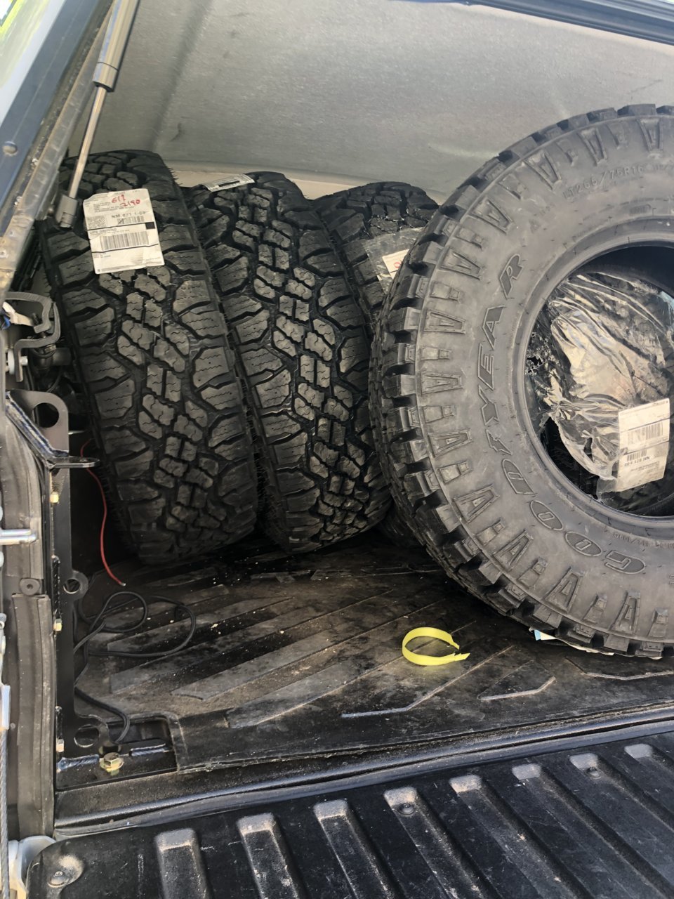

    4 Wheel Parts was (and may still) having a great sale on duratracs. I got 5 c-load (265) duratracs delivered for under $800

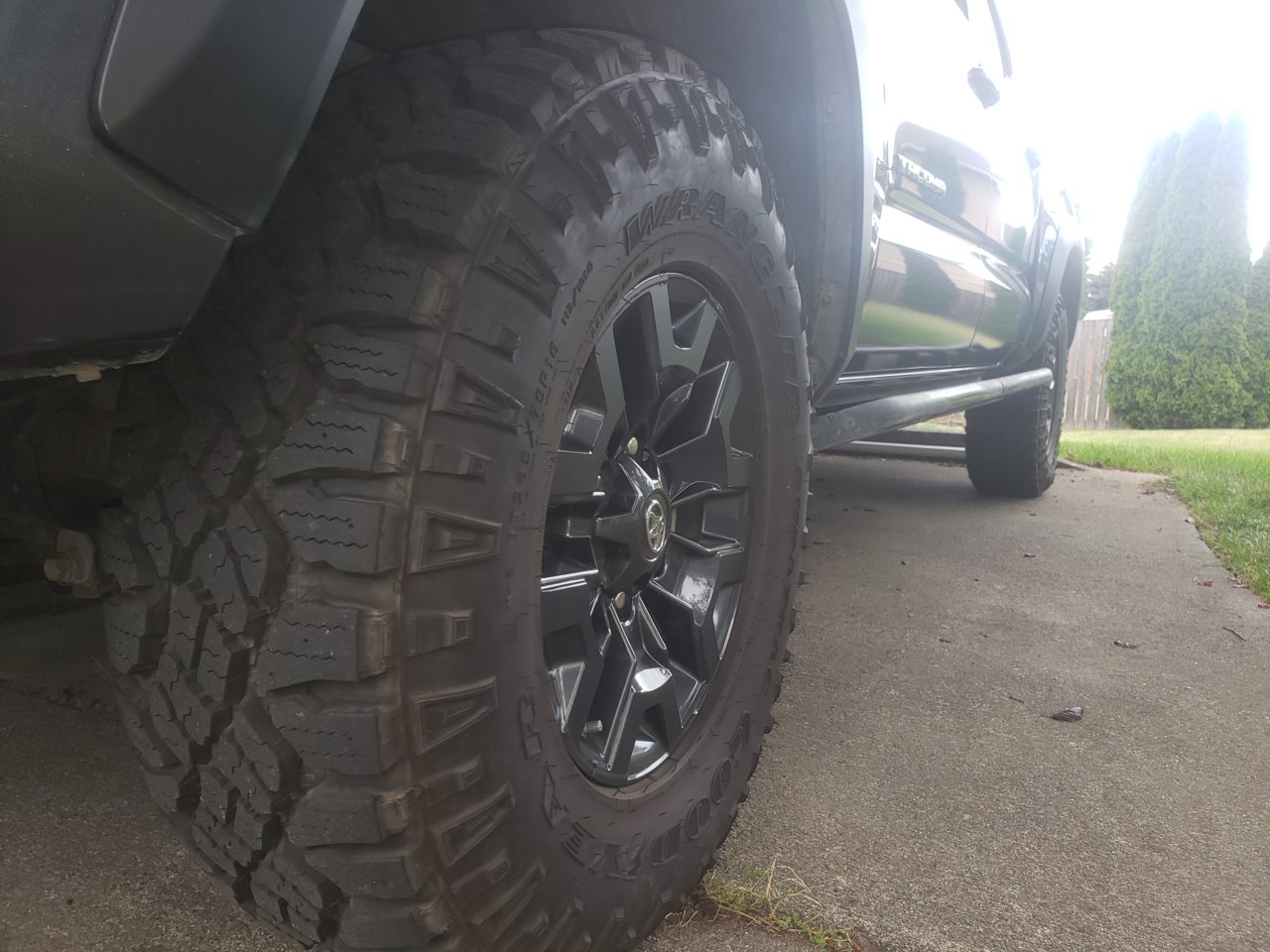

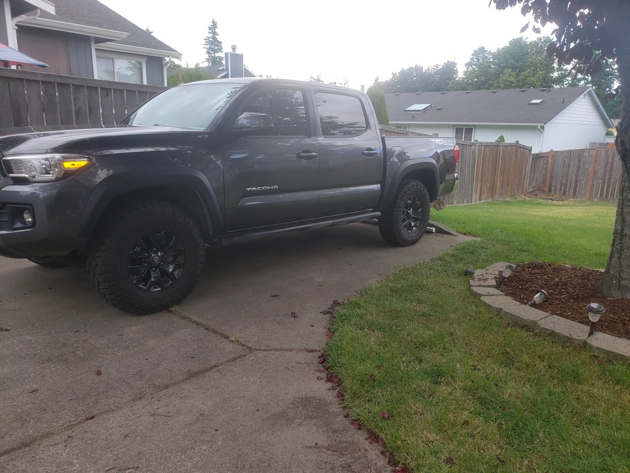

    Goodyear Duratarcs. Do well all around and are pretty good in the snow. 265/75/16 Come in C and E load. I think they come in SL too?
    Edit: for reference discount tire (think you have a Canadian version) price matched with mounting and certs out the door was $735 US plus a 100 dollar rebate
    Stock height TRD OR with 1 size up from 265 70 16 to 265 75 16 (30.6 to 31.6) average 19 to 20 mixed driving regularly see 20+ highway. C load 45lbs each.

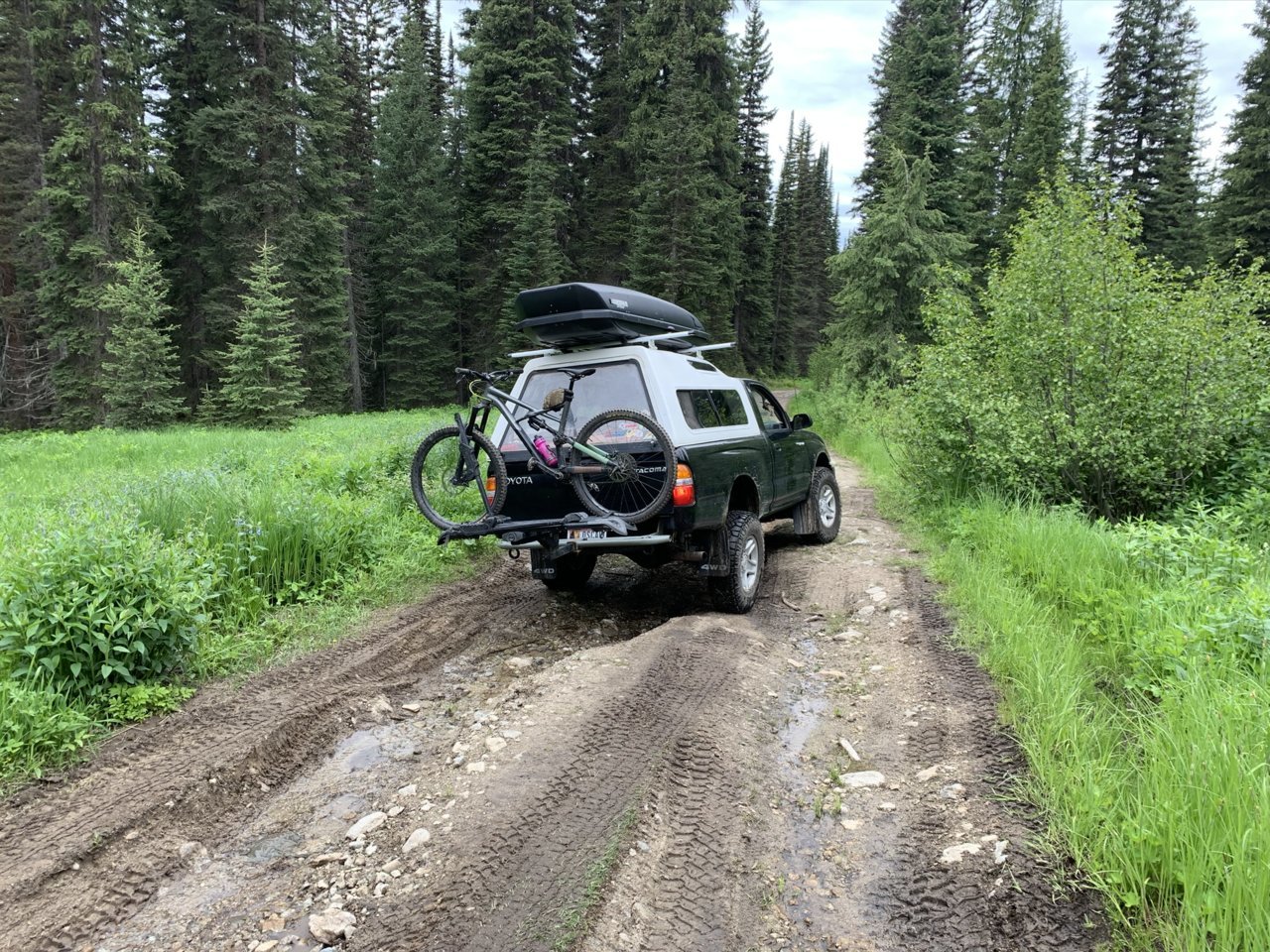

    OME kit 4.56's 235/85/16
    Narrow tires cut through snow and mud to find traction, as opposed to wide tires floating. Obviously not bottomless drifts or mud pits, but you get the idea.
    E rated tires are generally thought to have tougher sidewalls, lending peace of mind off-road.
    I have this size on my reg cab 1st gen and no complaints with handling vs. the p rated stock tires. And they are the same width as stock. Nice that I did not need to worry about any clearance, trimming, backspacing, etc. and nearly 32” tire. That, and sidewall toughness, is why I chose them.
    The first gen is a lot smaller, too, so the skinny tire does not look as skinny IMO. To each their own.

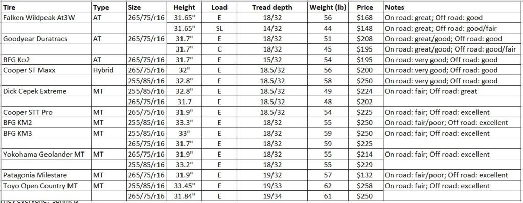

    Agree 100% ... is an awesome sheet and really helped me a lot.
