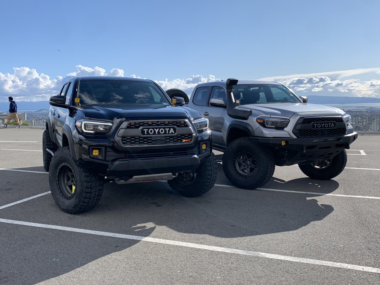

    All very good questions. A lot of people prefer the look of the 17x9. With 315/70R17 Tires. Or, just get true 35x12.50R17
    with that, it gives you that POKE. The Stance. It makes it look that much more aggressive. 969D7F8F-5A59-4EB6-9E72-0D6DECCD931C.jpg
    17x9 -38 offset on your left, 16x8 -12 offset with spidertrax wheel spacers on your right. We are both running 315’s.

    Interesting, yeah I see the difference there. I am currently Running Spridertrax but I'd like to not have to. I am making this switch because I poped two sidewalls on a trail this last weekend. Gotta replace two tires might as well go bigger. I'm thinking the wider the wheel the less chance of sidewall puncture, like the wheel would have protected the tire in the situation I was in. But I've never heard anyone talk about that. I am not super concerned about looks, but I suppose form follows function. Looks like I'll go with the -38 offset thanks.

    Is that black
    Tacoma
    Running wheel spacers with 35’s?

    No.
