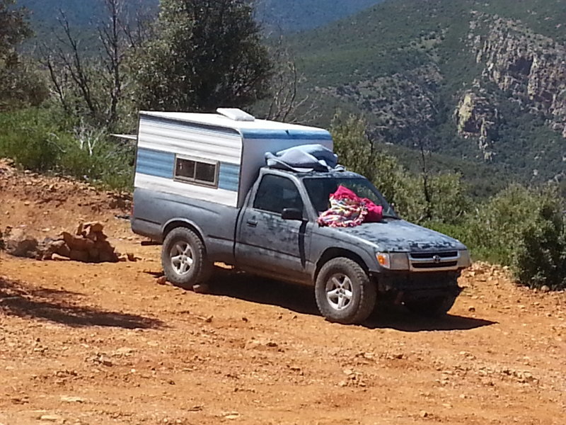

    i have 2000, 4×2, 5 speed, 2rz taco
    Vehicle was picked up and taken to a tow-yard - after i paid to get it out, it needed a jump - owner helped me out with his jumper-unit - polarity was reversed - lost power to everything - went through fuses - replaced 120amp alt fuse - got power back - truck cranks, no start - no spark from plugs, tested -
    The truck is now parked outside the tow yard and i need to get it running from that spot.
    I am homeless and live out of my taco currently - funds are beyond tight, every dollar i spend here will be missed.
    I have basic knowledge of most concepts i expect to face - i have a decent set of hand tools - i have a friend locally letting me use another vehicle to get stuff done (sedan, no towing) - truck was towed 40 miles away from where i have to hang out till this is handled
    Please, someone, guide me through this and maybe give me best case to worst case scenarios. I dont want to ditch my truck, but given my life situations i may have to. Absolute last resort.
