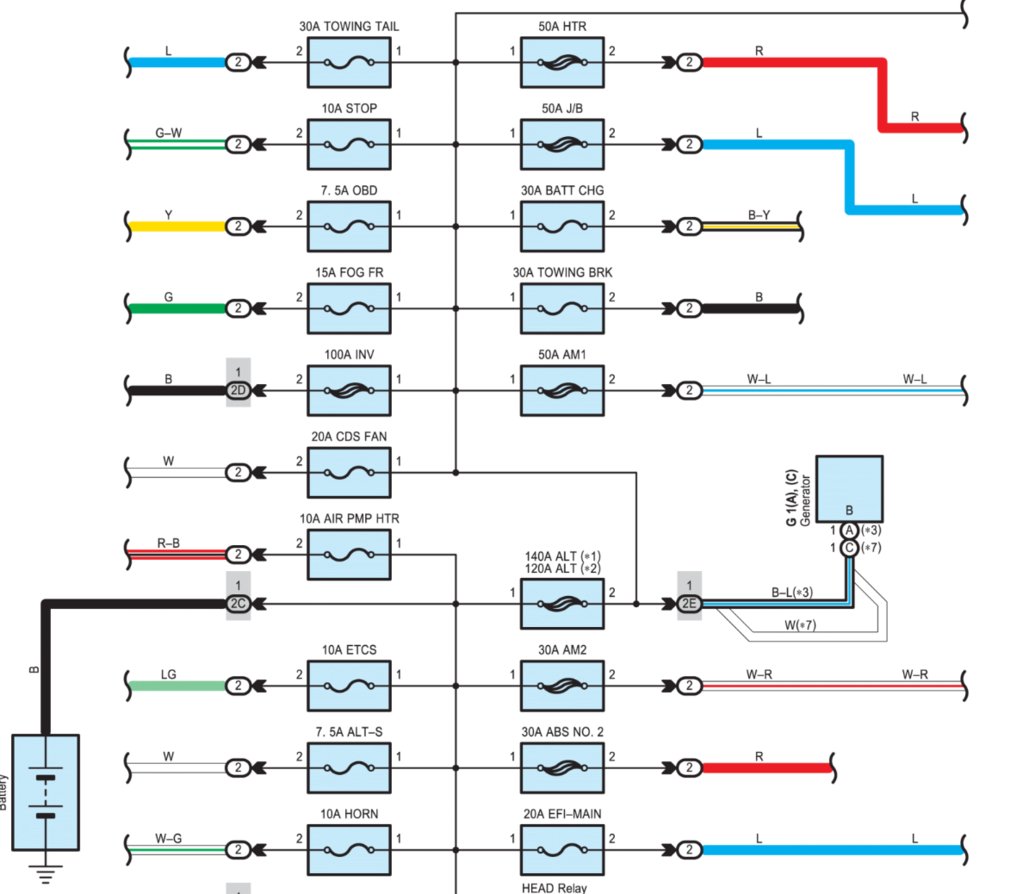

    Try the horn. If it works. You have power.
    If not, you have to check the big 120/50a fuse. You can’t just check them like a normal fuse. They are bolted in.

    These are the 3 main fuses...
    BenRod408[OP] likes this.

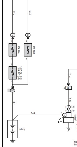

    Well there is AM1 and AM2 and the big ALT fuse. To be completely dead AM1 and AM2 would need to be blown or ALT and AM2 and even then the Starter Solenoid would still be powered.
