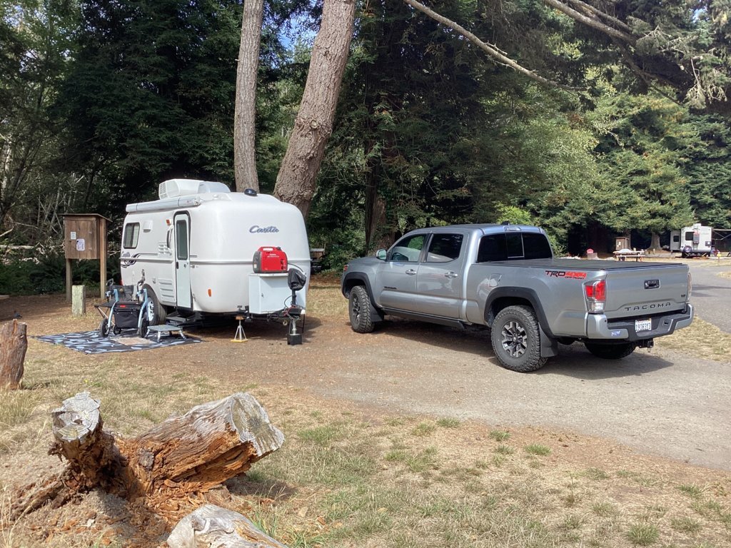

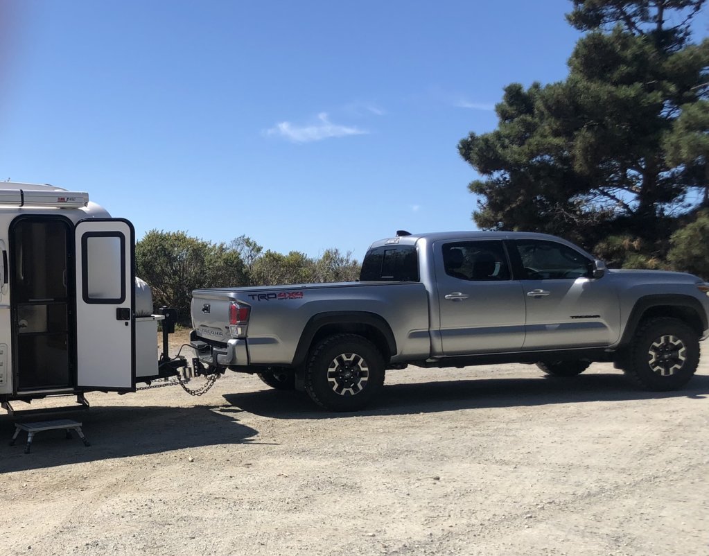

    My 23' TRD Offroad double cab long bed has a very sucky payload capacity just under 1,000 lbs. My trailer has a tongue weight of around 400lbs so I have to be very careful what goes in my truck. I solve this problem by carrying items in my trailer because my towing capacity is 6,500lbs and my trailer weight is just north of 3,000lbs loaded up prior to adding some additional items that I balance out in the trailer carefully in relation to the trailers single axle. I also added a Road Active Suspension to the rear and use a weight distribution hitch....The truck has built in sway control as part of the factory tow package.
    Take your time selecting your trailer. Do your research and don't get sucked into picking your trailer based solely on its interior size and amenities. Pulling a trailer that a tow vehicle can't do fairly easily or safely is no fun.

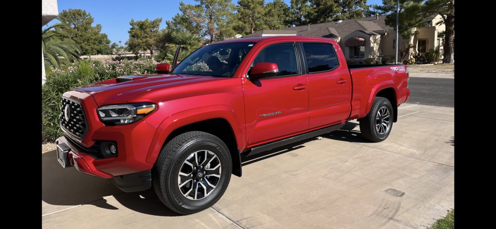

    Thanks “ Chew “ for the reply and helpful suggestions. It’s just my wife & I and we will be going up into the mountains. I knew it was going to be pushing it , that’s why I’m in this forum asking you guys in here that know much more about these trucks and their capabilities than I do. I special ordered this truck and it’s LOADED!! I went with every available Factory option except for the 360 degree camera ( I’ll never go off roading ) and the lock on the tailgate!! I’m assuming the “ Tow Package “ gives me everything I’ll need. Hmm So perhaps if I keep my Tacoma and purchase this trailer I should just do a ONE-DAY drive away from home trip and leave it at that so I won’t be hating a long 3,000 to 4,000 mile round trip. When I ordered this truck I wasn’t planning on towing at all , however , I decided to RETIRE March of 2024 at the age of 60!! Life changes , Right? I don’t want to damage my RIG , it only currently has 4,936 miles on it and that includes an 1,100 mile trip from Southern Oregon to Sun City West Arizona last year. We sold our home that we owned for 20 years and decided to move to an area where our retirement income goes a lot farther!!

    I think you are asking all the right questions and I bet you will end up with a trailer and towing set up you will enjoy. You have a better cargo capacity that I do so you should be ok there just by doing the necessary math. As for towing capacity, most of us here will tell you that 6,500lbs is technically doable but really no fun. Just my take, the V6 Tacoma when utilizing the S drive and the ECT a total towing weight south of 4,000 lbs is pretty doable. Keep in mind that is nothing more than my unscientific opinion.
    As for my trailer, I'm an ex tent camper and motorcycle camper so radwife and I don't look to a travel trailer as our main hang out. We need a full size bed, a small dinette, stove, sink, good sized fridge, heat, air conditioning and a bath room and shower, a wet bath works for us. We spend our time outside in camp unless the weather is bad.
    I found that most folks at travel trailer shows or sailboat shows, when I was a sailor, go inside first and then get seduced by the interior. Capability, reliability and performance are far more important than a pretty interior.
    I'm also very biased against stick built rigs, been there. They tend to leak and have no decent resale value in a few years. For all the reasons I stated we went with a fiberglass Casita. It is a family owned company in Rice Texas and they been building basically the same few models for 40 years. A plus, there is no middle man, no dealerships, you can only buy new from the company then make the pilgrimage to Rice for the pick up or they will deliver.
    They cost more than stick built but they hold their value. My 10 year old one is selling used for what I paid for it or more.
    Yes,I know....I'm a fan boy! However I have no affiliation with the company
