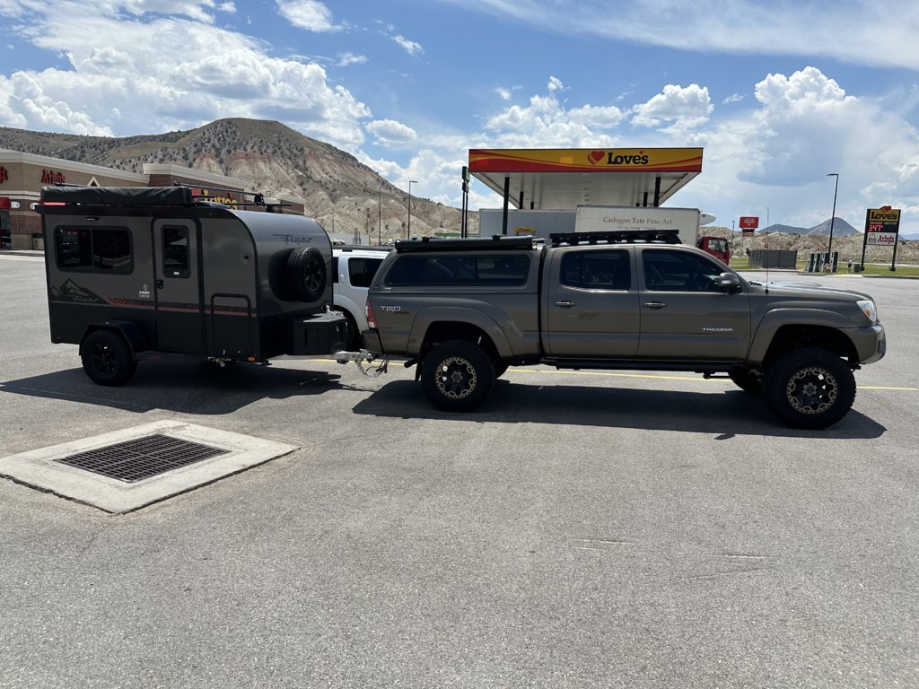

    A lot of good answers here. I have a gen 2 2013 long bed sport with tow package. Trailer is InTech Flyer Explore has brakes and weighs 2080 dry. Just under 3000 loaded. 280lbs hitch weight. Gives me enough for me my wife and the dog and about 100lbs cargo. Weights are accurate and certified at local CAT scale. I lose cargo due to lift, amp steps, oversized tires, canopy and racks. Last summer we completed a 3100 mile 8 Western state journey. Trailer pulled nicely but slowed to 45 mph going up the passes. Average fuel mileage was around 10 mpg. Sometimes less sometimes more if going down the other side. This required patience and planning so we didn’t run out of fuel or the enjoyment of the opportunity. Stops were mostly pre planned but there were a couple of unplanned stays due to weather, fire, or exhaustion. Something that most don’t talk about. Bottom line…the Tacoma is a great rig but a mediocre tow vehicle and you will feel it a few hundred miles into the trip. Brake controller is a must especially if you’re in the mountains. I use a prodigy…works great and was a cheap plug and play solution. For me I would not want to pull much more than what I currently have. If we chose to get a heavier trailer we will purchase a larger truck.
