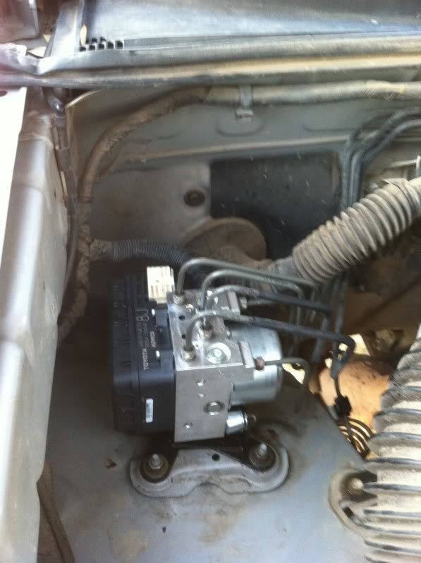

    i took mine to the dealer... i have always done all of the work on my Tacoma but i was lost when this happened to me.
    this is what they said was wrong with mine.photo17_2_0f1b55cc5bb72b36b985b01efb0ea338047bde9b.jpg

    what is that called and what does it have to do with the 4x4 and windows and ac abs and trac control. i hope its some thing simple i may just run it in to mar. is that some kind of ecu

    its the abs anti skid control module...
