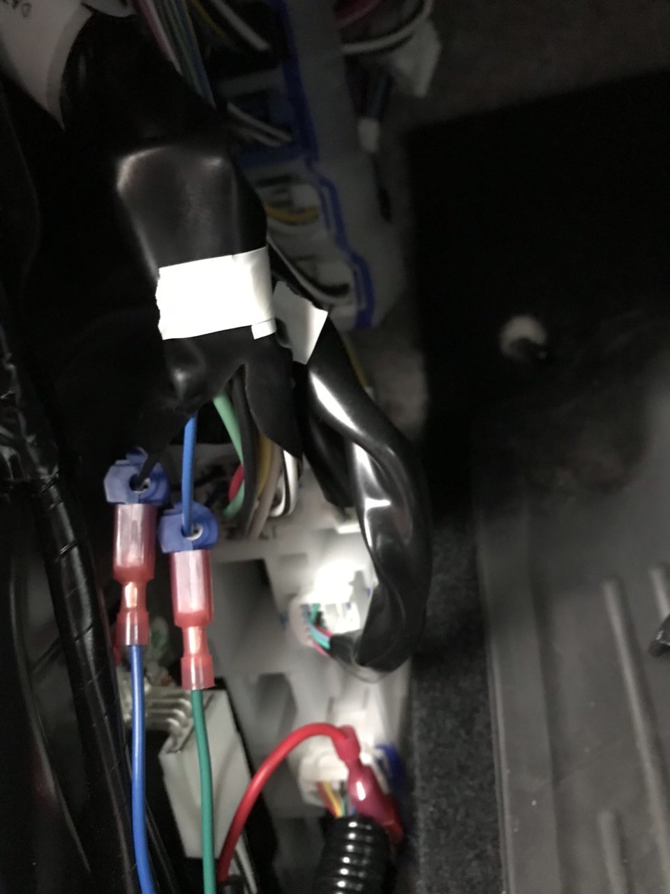

    Ok I got all the way to the wires under the steering wheel and now I'm drawing a blank. The instructions that came with it aren't helping and all the videos I've found online are through the passenger side.

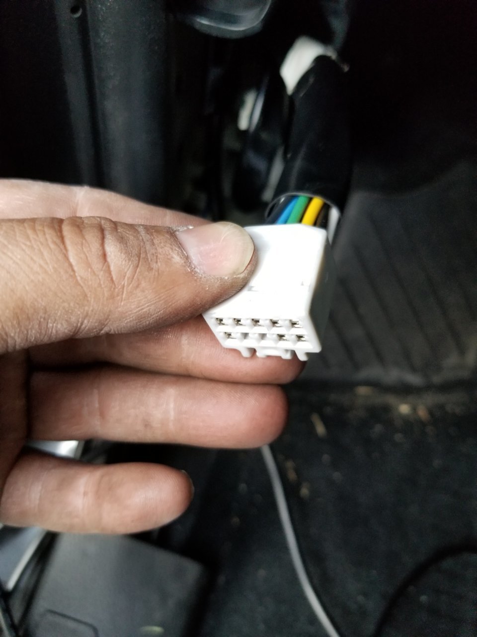

    The instructions say pull the 10 pin IC1 connector and attach the blue p&l wire to the black wire and the green p&l to the blue wire but theyre two black wires

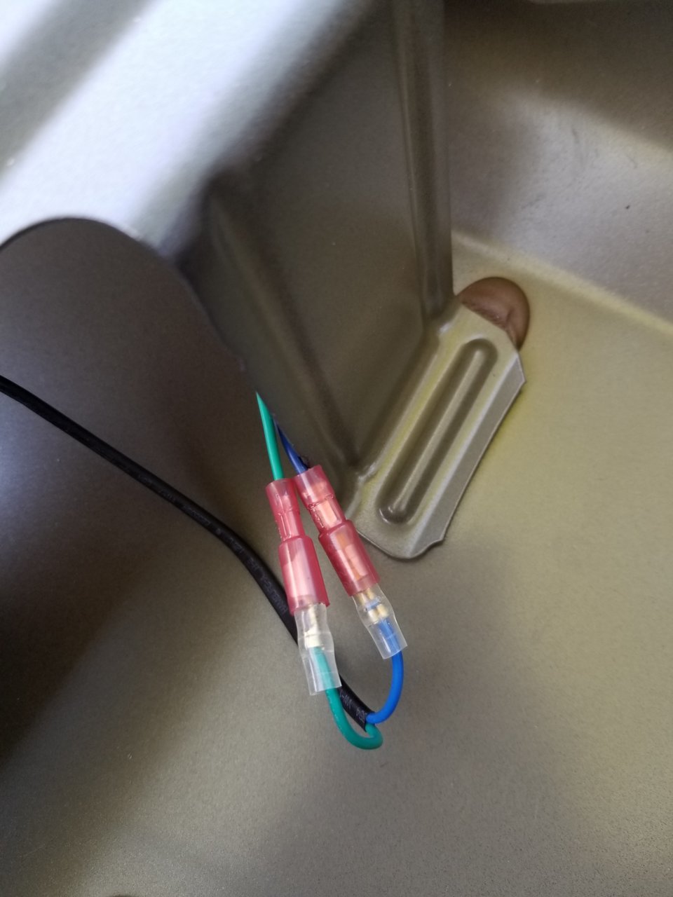

    Ok weird, I kind of got it going. I used the black wire that was the same gauge but when I unlock on the key fob it locks the tailgate. When I lock on the key fob it unlocks the tailgate. Tailgate wires are correct though

    That’s not how’s read the instructions, they even give you the PIN numbers so you can ignore the colors. But that’s the wrong connector, and green goes to green (pin 1) and blue to red (pin 3). Page 14 of the pdf.

    This is a factory (GST, Port install) Tailgate Lock wiring...
    BLUE to BLACK and GREEN to BLUE
    Ignore the red tap... that is factory (GST, Port Install) Bed Lights.
